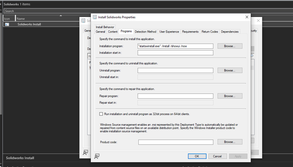

Have you got any kind of detection method in there? We are now deploying the 2022 SP2 variant and the same install command works. I assume you have created the Admin build and it is this that you are trying to deploy?

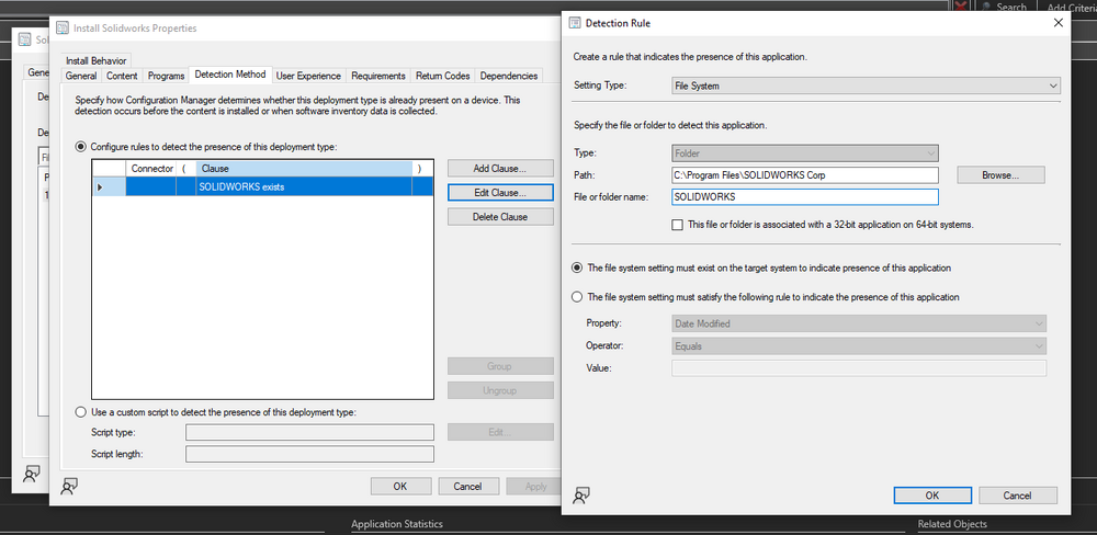

We are using a 'check for folder' method to detect if the program already exists or not. See screenshots attached
