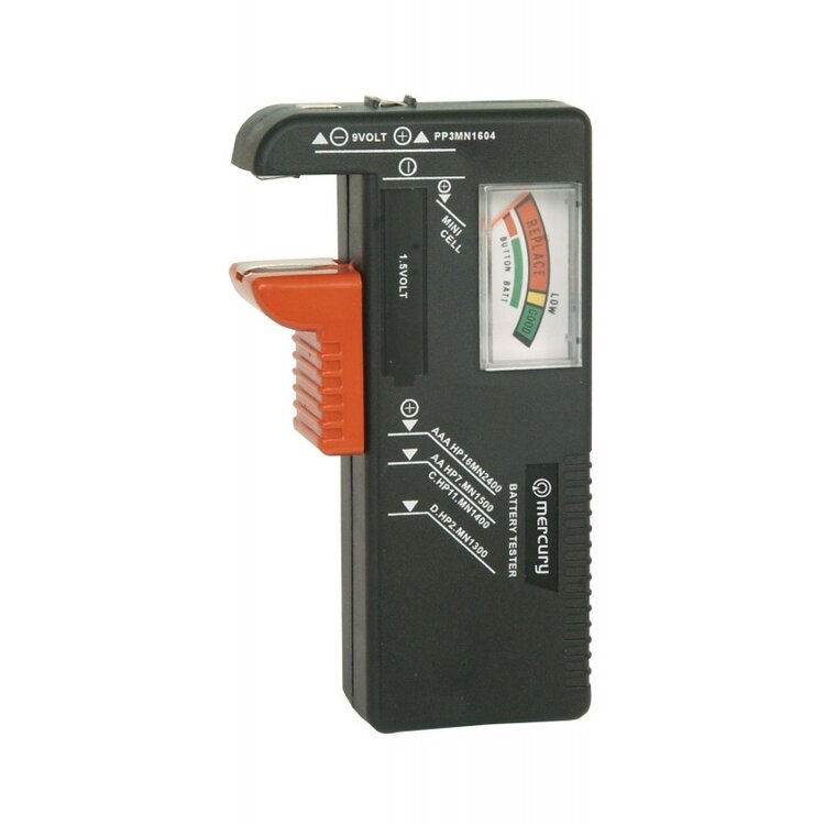

A multimeter set to volts will measure the open circuit voltage of a battery, which doesn't give a true indication of the battery charge status - an almost dead battery might still meet the rated voltage open circuit. You need to measure the voltage under load to determine state of charge. Even a simple tester like this (about £2 on CPC) will apply a load to the battery whilst reading and give a charge indication on the meter.
