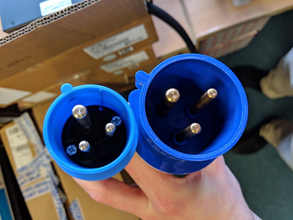

The plugs don't match.

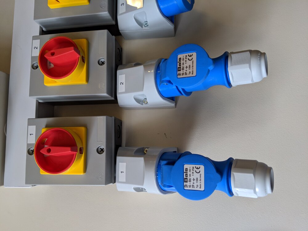

I have three of these on the wall put in by the electrician:
But the plugs on the APC units are much bigger.
Does anyone have any ideas on what I can do here?
The one on the left (which I think is a 2P+E) is the one the electrician put in and the one on the right is the one on the APC units. I have tried to rewire but the APC wires are so fat, they won't go in the smaller plugs.
Do I need something like one of these?
Edited by talksr
The electrician has installed 16A sockets, the APC unit uses a 32A socket.
Ok, do you think it would be easy enough to get these upgraded to 32a or would I be better off getting a different APC PDU?
It depends if the wiring and rcd is rated for 16a or 32a to be honest, although I expect if it's rated at 16a you'd probably have problems running 1/3 of your equipment off of it...
You'll have to speak to the electrician to figure out where to go from here.
The plugs on your APC units are the correct 32 amp plugs.
The sockets on the wall are incorrect 16 amp, need to be changed to blue 32 amp sockets, providing the wiring is capable of sustaining 32 amps, your electrician can advise.
