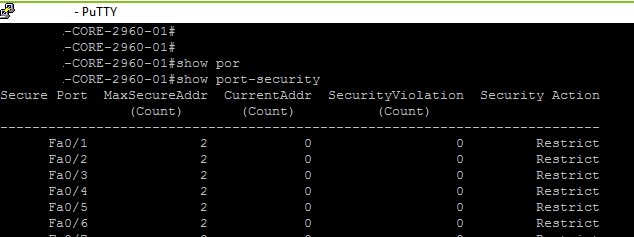

Port security on the switches set to 2 devices according to our network support!
I didn't even know that was a thing! Drove me nuts most of last week in the middle of upgrading the ICT suite to Win 10, it was the last thing I needed....
Great news!
Port security should always be enabled to limit the number of Mac Addresses, even if it say 10. It will stop a a couple of attacks.
1. DHCP starvation - If you don't limit the Mac Addresses you can get some software to generate a new Mac and request new IP Addresses, it then loops around and des the same thing. Within 30 seconds or so it can use up all the addresses on your DHCP scope. This will mean legitimate clients won't be able to get an address.
2. Mac Address Table Overflow - Some other software can be used to fill the Mac Address table of the switch. When this happens the switch turns itself into a hub. When this happens they can they eves drop on the network and see the data.
