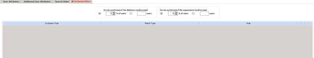

fiza Posted June 13, 2018 Report Posted June 13, 2018 The sync log should tell you why the accounts were not created or at least give some indication. If you can post up screenshots of your GCDS User Accounts setup screens (User attributes, Addtional User Attributes, Search Rules & Exclusion Rules) might help diagnose the issue.

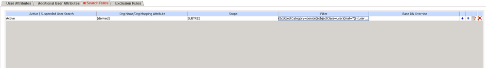

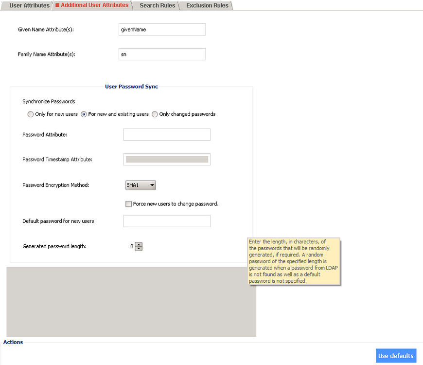

fiza Posted June 13, 2018 Report Posted June 13, 2018 Couple of things not sure if they will solve your issue or not. You have sync passwords for new and existing users but dont specify a password attribute. On the search rules page what have you got as your Rule? We have (&(objectCategory=person)(objectClass=user)(mail=*)(!(userAccountControl:1.2.840.113556.1.4.803:=2)))
fiza Posted June 13, 2018 Report Posted June 13, 2018 So, the 20 users it has created, are in the top level domain and not located in the folder structure in GSuite. It has created a folder tree but not all of it and added a few of our email service accounts which is what is supposed to have done but that's it. In GCDS i have got OUs, User Accounts, Groups and User Profiles ticked to Sync. I have a fair few exclusion rules set so specific OUs don't get carried over to Gsuite. I've just removed a line from the Org Units > Search results and now if i click on test sync it's pulling in all OUs. Surely Google can make a better product than this?! What have you put in as your Base DN for Org Units in GCDS? We point the Base DN to our Users OU in AD and then replicate the structure under the users OU into G Suite. We tick "Do not create or delete Google Organisations, but move users between existing organisations as specified in the User Sync Rules"
timbo343 Posted June 13, 2018 Author Report Posted June 13, 2018 Couple of things not sure if they will solve your issue or not. You have sync passwords for new and existing users but dont specify a password attribute. On the search rules page what have you got as your Rule? We have I'm not too fussed about the passwords at this point in time, i just want the users to come across.

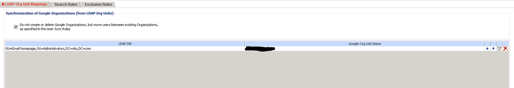

timbo343 Posted June 13, 2018 Author Report Posted June 13, 2018 Couple of things not sure if they will solve your issue or not. You have sync passwords for new and existing users but dont specify a password attribute. On the search rules page what have you got as your Rule? We have What have you put in as your Base DN for Org Units in GCDS? We point the Base DN to our Users OU in AD and then replicate the structure under the users OU into G Suite. We tick "Do not create or delete Google Organisations, but move users between existing organisations as specified in the User Sync Rules" The base DN for Org units is dc=shs,dc=com as we have an administrators as a separate OU away from SHS Users. I'm wanting to sync SHS users for now. My exclusions seem to be working
fiza Posted June 13, 2018 Report Posted June 13, 2018 The base DN for Org units is dc=shs,dc=com as we have an administrators as a separate OU away from SHS Users. I'm wanting to sync SHS users for now. My exclusions seem to be working So according to that screenshot GCDS is looking at an OU called "Email Homepage" and looking for users and OUs under that. Is that correct?
