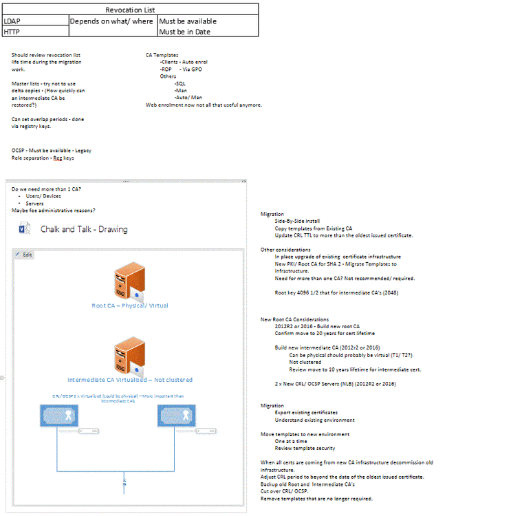

HPlum78 Posted May 11, 2018 Posted May 11, 2018 (edited) My first thought on this is not to use a DC for your Root CA, I would try to keep the root CA offline and only power it up when required. Some useful info here https://social.technet.microsoft.com/wiki/contents/articles/2900.offline-root-certification-authority-ca.aspx and here https://technet.microsoft.com/en-us/library/cc700804.aspx Above are some screen grabs of a chalk and talk with MS I had recently. Edited May 11, 2018 by HPlum78
