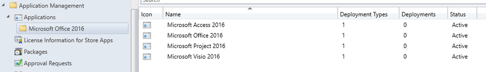

I've added the Office installer scripts into (what I assume is) the Applications pool (Application Management, Applications) but I'm trying to add them as a step in the Task Sequence but it doesn't show them?
The scripts themselves are nothing fancy, just batch files with START /WAIT "Office 2016 Setup" "\\Server\Share$\Path\Setup.exe" /config "\\Server\Share$\Path\Config.xml"
I can't really find any information about this because it appears Microsoft use the same "There are no items to show in this view." error message across a bunch of other applications.

Did you check the following box in your application?
Yeah, that's ticked on all 4.

Stopped being techie about it (searching error messages) and started being an end-user about it (phrases like "not showing in list")
Application properties/Deployment Types/Deployment type properties/User Experience
Logon requirement: Only when a user is logged on
Changed that to "Whether or not a user is logged on" and it shows up.
