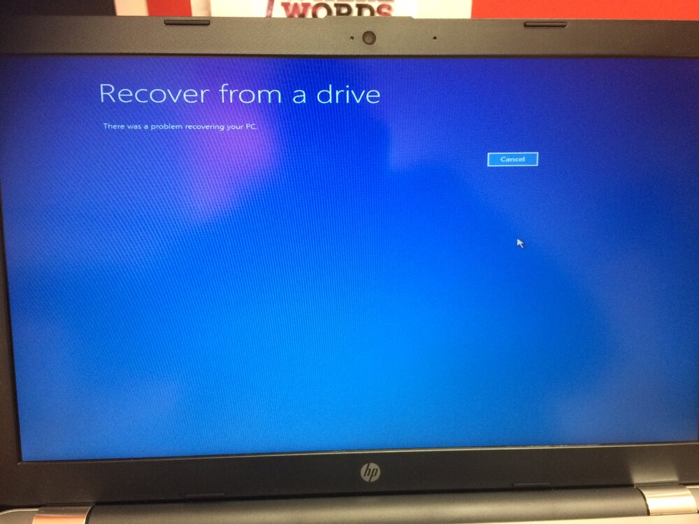

Koldov Posted February 20, 2018 Author Posted February 20, 2018 It sounded so easy Created a 'Recovery Drive' and tried to restore it... Helpful and informative as always, thanks Microsoft! Must be doing something wrong! Oh for the days of my tatty old battered CD with a dodgy copy of Ghost on it...

Koldov Posted February 21, 2018 Author Posted February 21, 2018 Are you using MDT? No, we don't have anything like that set-up here. Just a usb drive. It seems to either go round in a circle if I choose the boot option 'USB Hard Drive (UEFI)' - Choose Language and Keyboard > Use a device > EFI USB Device > This takes me back to Choose Language etc... or if I choose Troubleshoot > Recover from a drive it gives me the error 'There was a problem recovering your PC'...
Koldov Posted February 21, 2018 Author Posted February 21, 2018 There is also a difference when I disable 'Secure Boot' and enable 'Legacy Support'. When I do that I see the USB drive, but with and without UEFI as an option and when I select the one without, I see a blue Windows logo instead of an HP logo. However, it gives me less options on the next page (normally Continue, Use a device, Troubleshoot, Turn off your PC) it only has 'Troubleshoot' or 'Turn off your PC'. Choosing 'Troubleshoot' gives me 'Recover from a drive', HP Recovery Manager' or 'Advanced Options'. Choosing 'Recover from a drive' takes me to 'There was a problem'.... Choosing 'Advanced Options' only gives me standard 'Start-up Repair' options.

Koldov Posted February 21, 2018 Author Posted February 21, 2018 Does the HP Recovery Manager let you use your HP backup? Might be worth trying and then creating a non-HP backup another way (Clonezilla?). I'd probably just bite the bullet and install W10 from disk/USB, but don't want to be responsible it it makes matters worse for you! I can use the HP utility to create and restore a backup using the HP app, that's fine (I'm just conscious that once wiped, that app won't be there anymore). Yeah, for sure I'm over thinking it, I am interested in why it isn't working though. I'm sure I'll never even need it (famous last words). But....
