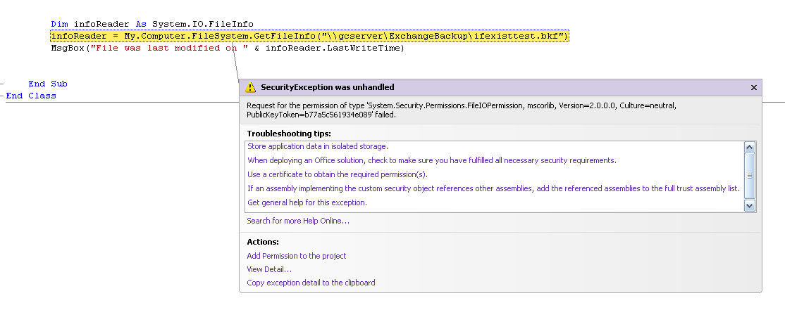

This is the error im currently having, i stripped out all the caparison code, and just got it to output into a MSGBOX but i keep getting this error. and as usual, microsoft help is no help!
screenshot should(first time using uploaded) attatched..
You're running it from a network location? Copy it onto the local hard drive, the framework gets stroppy about security otherwise.
Never used it, but this sticks out a bit:
My.Computer.FileSystem.GetFileInfo
"My Computer" could be a problem considering the file is on some other computer. Get rid of that and try it the System.IO.FileInfo way bizzel mention back in March.
Basically, that error boils down to "nuh uh, I don't have permission to access that item", which could be a lot of things. In this case, it's telling you that it doesn't have permission to read. Assuming that you can access the file with explorer, I'd give System.IO.FileInfo a spin and see if that changes anything.
