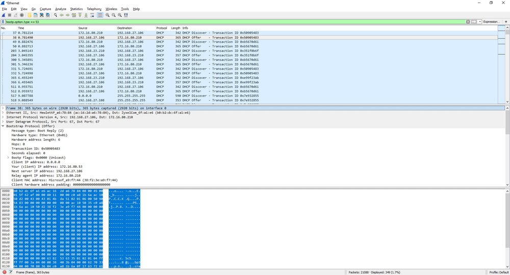

Hi i cant get devices on the wireless vlans for teachers and students working - they are not getting DHCP - if i put manual ip address's in they work ok
below is my wireshark print out with details of devices
17.16.80.210 is the teachers vlan on on HP flex 5700
192.168.27.106 is my dhcp server
in wire shark i can see that the dhcp relay is working as it gets to the dhcp server and the dhcp server offers back an ip address, but my devices dont recive any address..
this has got me stumped

Switch is a hp flexfabric 5700
we have 4 vlans, with the switch having an interface in each vlan
its hp so it is dhcp relay rather than ip helper and it is configured -- i can see dhcp requests from the vlans on the dhcp server coming from the switch ip in each vlan
i have the dhcp scopes setup on the server and the server is sending a corresponding ipaddress back to the switch depending on which vlan requested it.
I have had this working on my old server 2008 and old core switch, and as far as i can see everything is setup the same

On the screenshot above you can see that dhcp relay is forwading to the dhcp and the server resonds with a correct ip address
for anyone else who might read this i had to add static routes on the DHCP sever and everything works fine.
