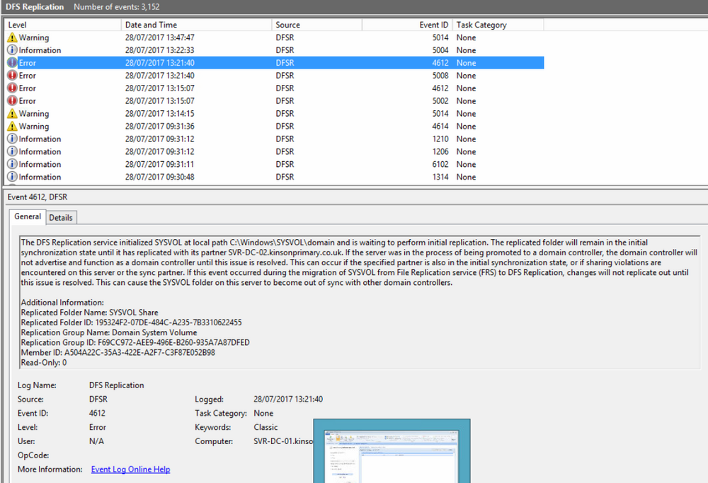

Hi Chaps,
Ok, so I have an issue where by when I demote my last 2012 R2 DC it complains that it’s the last DNS server hosting the Zone as it is unable to contact any other DC despite seeing them.
The new 2016 DC has an IP that has never been used before, has all the FSMO roles, DHCP services look to work fine according to the Event logs, Best practices and DNS look fine according to dcdiag.exe /test:dns and FSMO checks out fine too.
Below is the error it comes up with. I have already proceeded with it yesterday and it does in fact remove the entire DNS Zone, which is not helpful. That goodness for Checkpoints and Virtualisation.
Please help.... I did this on my SVR-DC-02 yesterday and it said the same. Today I demoted the SVR-DC-02 with no issues but the SVR-DC-01 now say the message despite yesterday being ok, so it looks like an actual issue. Maybe I need to do somthing I dont know about?

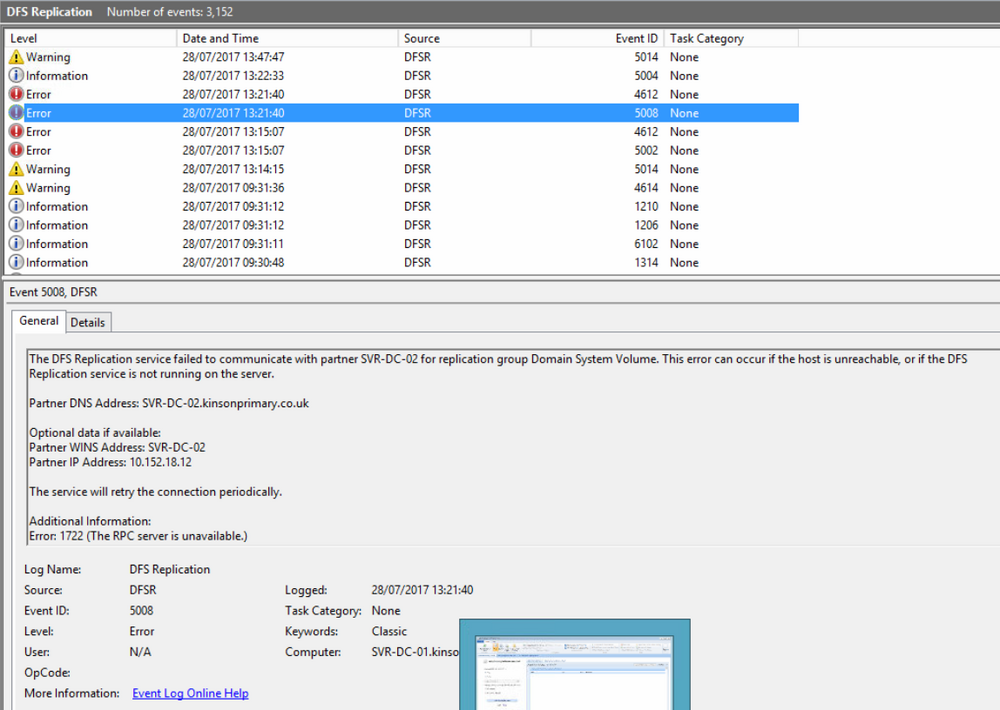

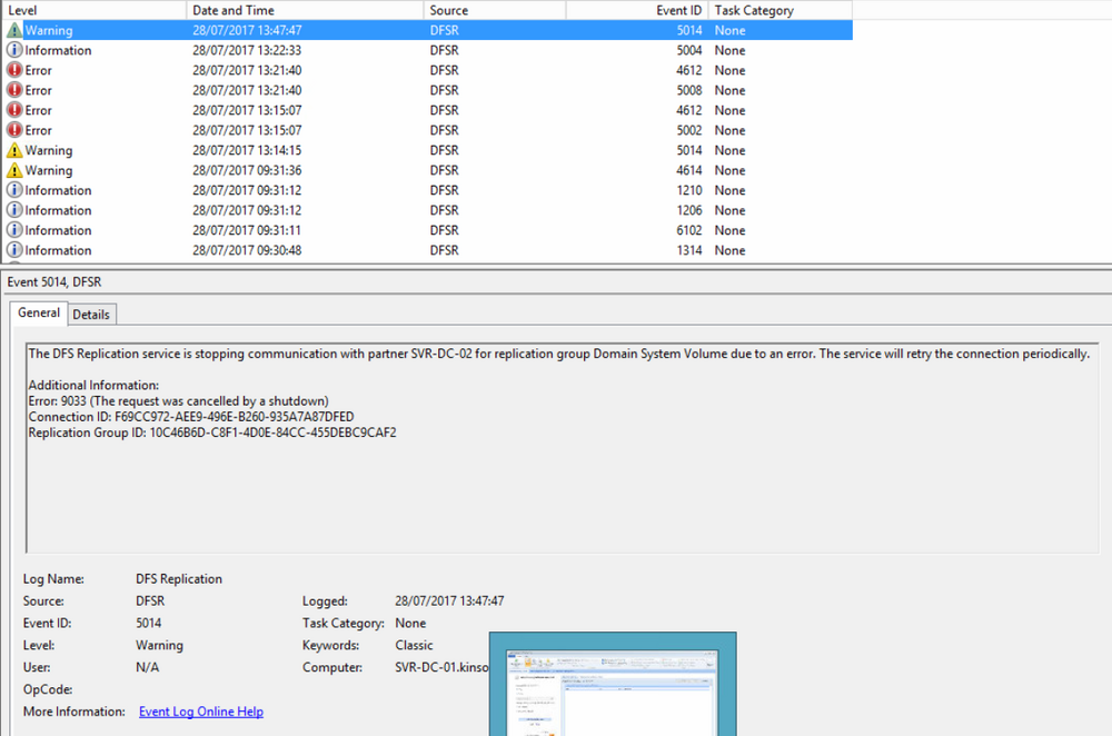

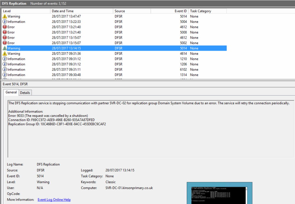

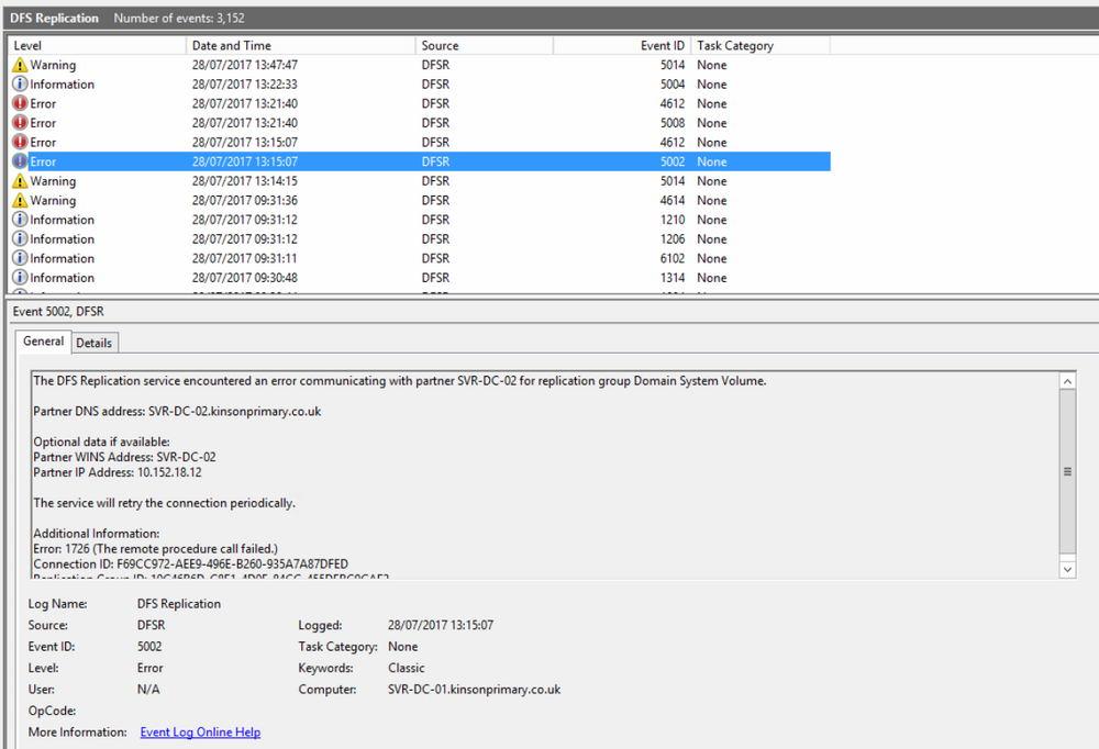

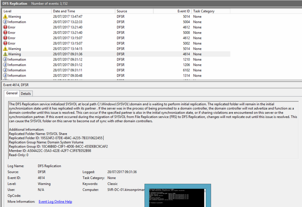

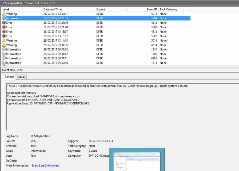

Do you know if you are replicating the sysvol/ netlogon shares via FRS or DFSR? If it's via DFS can you check on the original DC(s) for event 2213 in the DFS replication logs(if it's FRS then the 2016 DC will never get the sysvol/ netlogon and that needs sorting first). When you are browsing to the netlogon/ sysvol shares where are you doing this from? As don't be fooled in to thinking that these are being replicated if you are just \\ ing these from a client. A quick way to verify that each DC has these shares is to \\ each DC directly so \\SVR-DC-02\ you can even try creating a file directly in each servers netlogon folder and then watch it appear in all the other servers netlogon folders for a quick a dirty test.

hold on a second I have just reread your initial post can you check in each of your domain controllers for event id 2095 (in the directory service log)... Let's rule out any usn rollback issues here as well. Edited by HPlum78
Hi Guys,
The issue seems to be with the original two DCs about 4 weeks ago. I dont know what has happened but they seem to not replicate from the SYSVOL folders. I basically went back as far as I could with the restore on both DC's and looks to be from then rather than when I added a 2016 server.
It might have been after I moved the FSMO roles from SCR-DC-01 to SVR-DC-02 or a corrupt GPO or permission some how.
