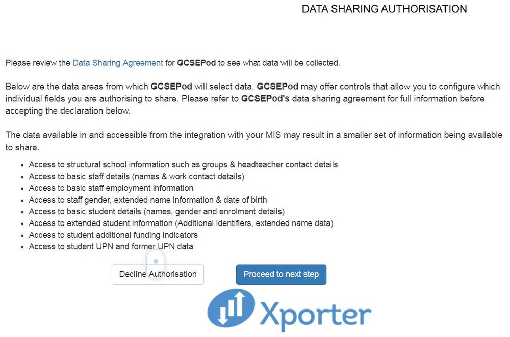

From GCSEPods Data Sharing Agreement:
[ATTACH=CONFIG]49010[/ATTACH]
That's all well and good, but surely GCSEPod should only be measuring the impact by key demographics if we have asked them to. I suppose, it is data you choose to share with them when you set up the exporter, so you have the option to withold it there (which is what we've done, as we aren't interested in the ratio of PP:non-PP users of GCSEPod.
GCSEPod are saying that taking that data (pictured) is optional to them.
I believe you are referring to optional fields rather than mandatory fields. This means that we do not require this information in order for GCSEPod to work correctly and unless selected, XOD will not extract.

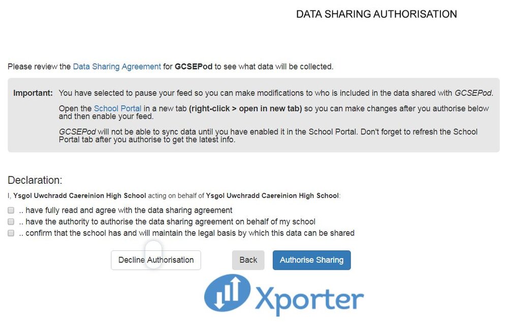

The agreement is worded very much like they are telling us what to do rather than acting under our control.
I just don't like that we are agreeing to give it to them. If we withhold it aren't we breaking that agreement. Their agreement is very much a legal document.

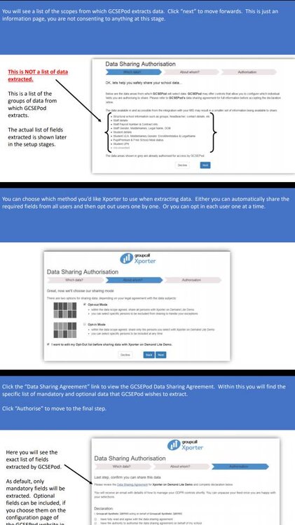

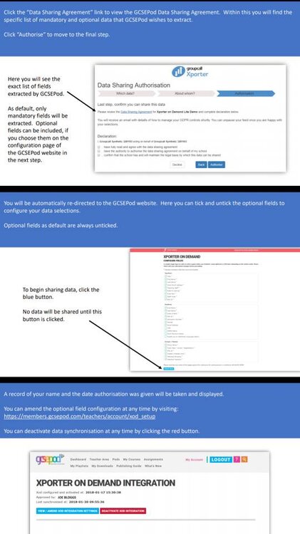

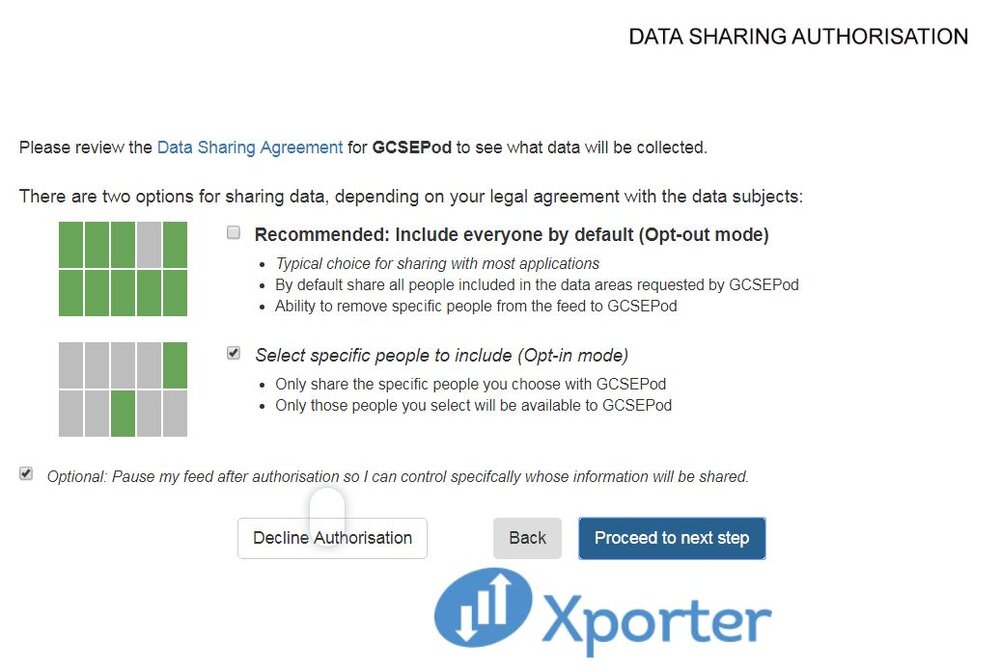

We have all students selected on that screen you put in your recent post, but a bit further on in the setup, I think you get the option to select which fields are uploaded and we haven't ticked SEN, etc.
Hmm. I thought that second screen was it.
I thought it was possible in XOD to see what data we're sharing with the processors, but I can't figure that out. Any ideas?
