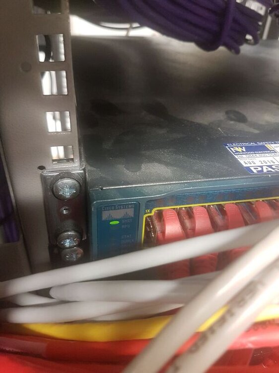

SYST.jpg They are stuck like this. cannot get in via console cable. fan spins for around 2 seconds then dies down and nothing. Not even pressing mode or power cycling with more pressed in for 15/30 seconds.
Flashing light normally mean cannot find is. If you can get into console try typing boot. It will tell you what's happening

It's a solid light and when consoled in with cable and putty doesn't display anything, a blank black screen.
You have removed any stacking cables and things plugged into it. Once it starts to boot it runs diags and if something is wrong it can get stuck
Yeah, removed all cables. I have it on the desk next to me with only power and console cable plugged in. As soon as I power on fan spins for a few seconds then 'SYST' light is solid green. The open session with putty doesn't display any life.
