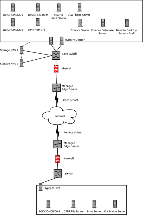

This is how we're implementing it in our 6 school trust. The diagram isn't complete but it is a start. Each site has direct internet access, with a VPN to the core sites for core services. So, each site will be able to run should internet go down at the individual school or at the central school.
All files will be stored on our central servers, and DFSR'd over to any site where a member of staff works (gotta figure that one out yet but shouldn't be too hard).
DC, DNS and DHCP on each site then if connection does go down you can still work. A MPLS cloud is ideal for this, connectivity between each site but internet connection if one of the links fails between sites.
