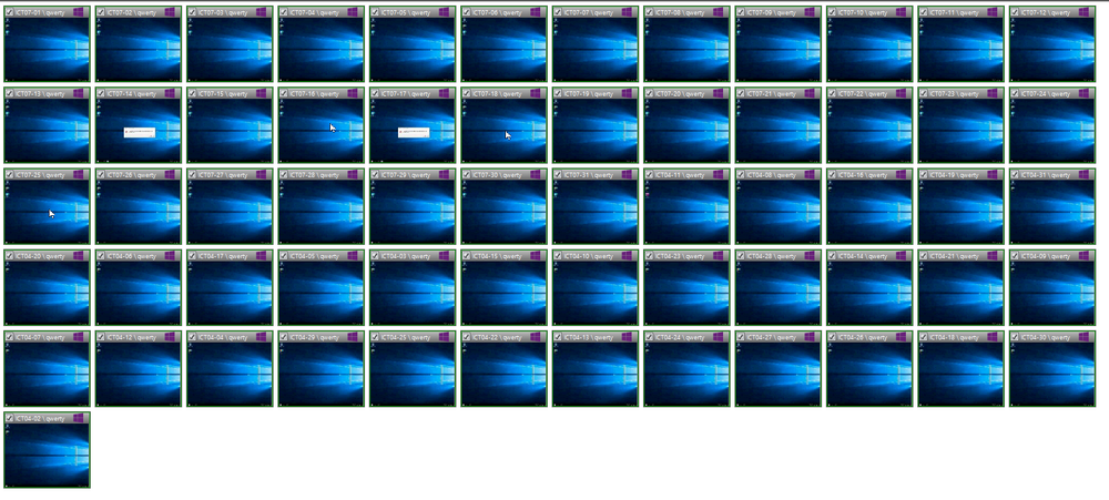

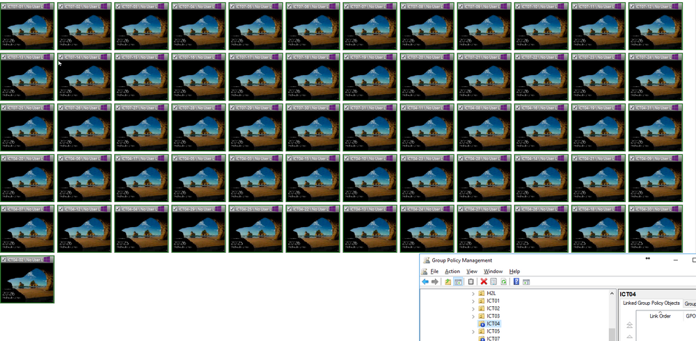

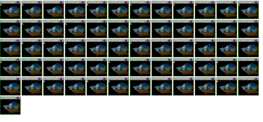

Logging into the machines with no Group Policies applied to them:
Errors on 2 machines:

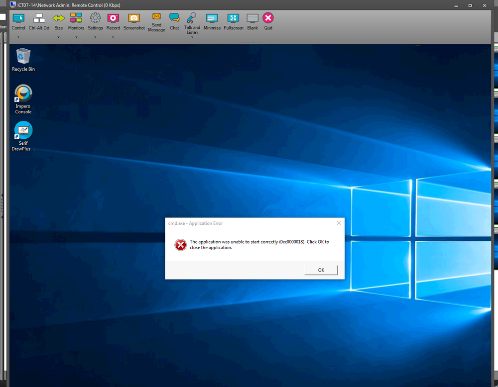

The Error:

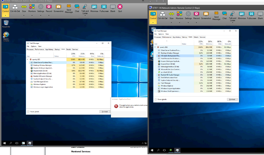

Difference between a non working machine and a working machine

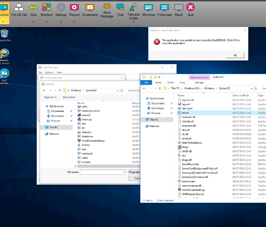

When running task manager and clicking File > Run, browse to C:\Windows\System32 we see the run box doesnt show all the EXEs but yet if we were to use File Explorer to browse to C:\windows\system32 on the same machine we can see all the EXEs.
