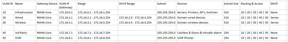

My next step is to VLAN our main network up to reduce broadcast traffic. In time I'd also like to introduce client access lists for but the moment all these new VLANS would be interconnected. Here are the VLANs I'm proposing:
Currently our main network is on 172.16.0.0/16.
