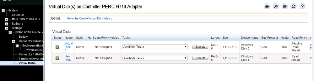

Joanne Posted February 10, 2017 Posted February 10, 2017 If you want to see what RAID array it is on Open Manage you go to system - storage - PERC adaptor - Connector - Virtual Disks
