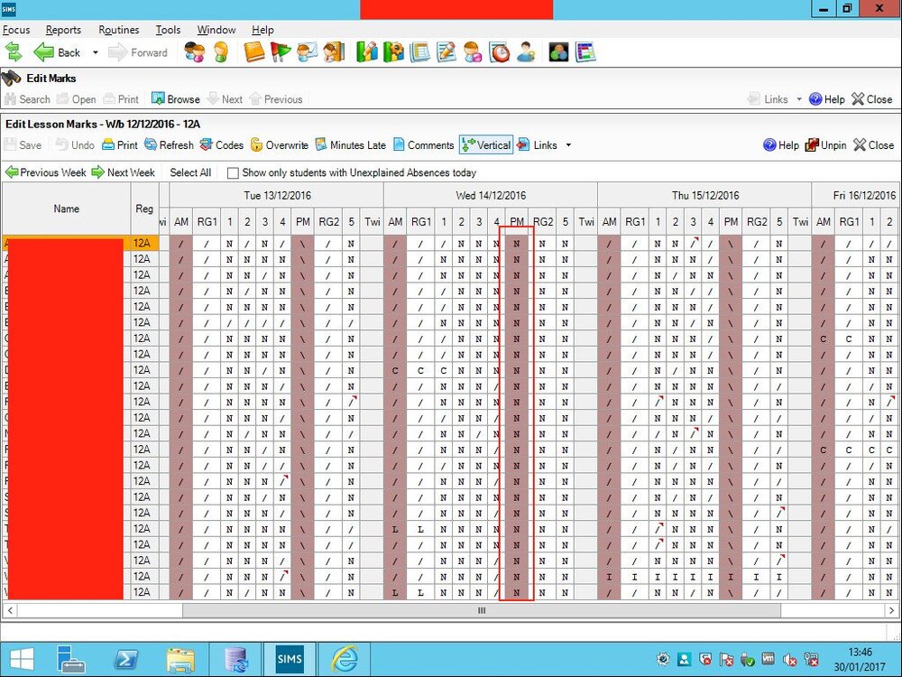

We've proved beyond reasonable doubt that the routine:
Focus -> Lesson Monitor -> Enter a Code over a date range on our DATA for our Year 12 and 13's when chosen with the option "Preserve Data" does not always "preserve data"....
So correct / and \ marks which should be preserved when using that routine are over-written seemingly in random AM and RM registrations for seemingly random tutor groups.
However there has to be a pattern to it!
If I run a "History of Changes" report it shows who entered the original Lesson Monitor mark - does anyone know if I can run a report which will show who took registers for particular sessions or lessons to see if that helps identify the commonality between the marks that get over-written.
Example of marks from Wed 14/12/2016 being over-written....
Where would SIMs be pulling those session marks from in your screenshot? It shows Ns for RG2 and 5.... Edited by bobsmith
spelling
Those we put in by doing the routine : Focus -> Lesson Monitor -> Enter a Code over a date range
What we were finding though is that it appeared to be overwriting random \ and / marks with N's when that procedure should only overwrite "missing marks" (-'s)

Occasionally it appears the RG2 mark is not completed, just the PM reg.
So when the routine Focus -> Lesson Monitor -> Enter a Code over a date range is chosen, even with preserve marks set it was acting on the RG2 column and replacing any missing marks with "N''s - these were then copied over the "PM" column.

And unfortunately even with the preserve marks button in the locked position it over-wrote 100's of actual marks in the AM/PM columns because even though they were filled in - somehow the corresponding RG1 and RG2 field were empty - they then got overwritten with the "N" codes - which then auto-copied over the real marks in the AM/PM columns with the "N".

I understand now what happened.
And I'll document here in case it catches anyone else out.
Teachers were all correctly filling in the registers using the RG1 and RG2 sessions which then copied over to the AM and PM slots.
Unfortunately one admin person who was responsible for doing 6th form registers was ONLY filling in the AM and PM slots - she would block do this for all year 12 and 13 if they had say assembly instead of registration, she'd also do the registers if a teacher was off for example.
This same admin person then incorrectly used the routine : Focus -> Lesson Monitor -> Enter a Code over a date range
Even though the preserve marks option was set - the routine overwrote all lessons and registers where there was a missing mark ( "-" ) - which of course was in all the RG1 and RG2 columns adjacent to the AM \ PM she had filled in.
Once the mark had been copied over the RG1/RG2 columns it then AUTOMATICALLY copied itself over the marks she had put in the AM/PM columns - thus losing a lot of data!!!
So the preserve marks option does not take in to account the "Copy Lesson Marks to Sessions" feature.
