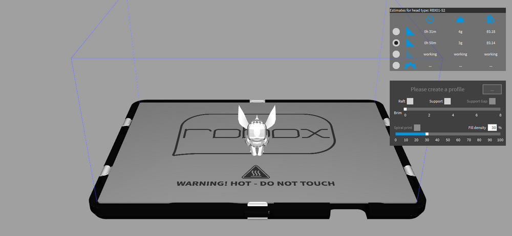

So the software I have tells me how much it costs...

No, the reels come in at just over £30 from CPC and they last for a long time for multiple small prints. The software for printing is awesome too, it tells you exactly how much filament you have remaining and how much the print will use at differing print settings and how much it costs.
