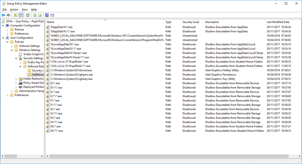

These are the current policies in place:
But I can still run tools like Open Hardware Monitor from a memory stick (D:\)

Still not working as a computer policy.
I can still plug in a memory stick as D:\ and run Open Hardware Monitor.
And I've double-checked, EXE is in the 'Designated File Types' list.

Because it's too late to do a whitelist only as we're 'live' and I don't reckon I have the time to fully test a whitelist-only solution.
I'd like to do that, but for now I just want to get the minimum infrastructure in place to stop what's happening right now.
I am doing it on computer policy now, but without *.. I'll add asterisks and see if that works.

Both.
If I run it from D:\ (more specifically: D:\OpenHardwareMonitor\OpenHardwareMonitor.exe) it launches fine. No mess, no fuss.
I remembered the \*\* entries mentioned earlier, so I've tested running it from just D: (D:\OpenHardwareMonitor.exe) and that still works, too
If I run the OHW exe from inside a .zip folder, I get a message coming up saying it couldn't find Aga.Controls.dll (which is simply because I'm not extracting the full folder contents, goes back to my mentioning I don't have an exe on its own that works without supplementary files) - I take this to mean that the exe is still running, looks for its supplementary files, can't find them and throws an error.
Try these as they block it fine here, just tested with the same program too (doesn't get to any dll issue as it blocks the exe before that)

Edit: I'm already using 'D:\*' though, and that doesn't work.

And the results are in: No change.
I've put them back in as User policies too, and, still nothing.
This isn't like the bloody IE settings where I haven't pressed F5 somewhere to enable something, is it? Like I'm setting all the policies but I've missed something somewhere so none of it is actually getting enforced?
