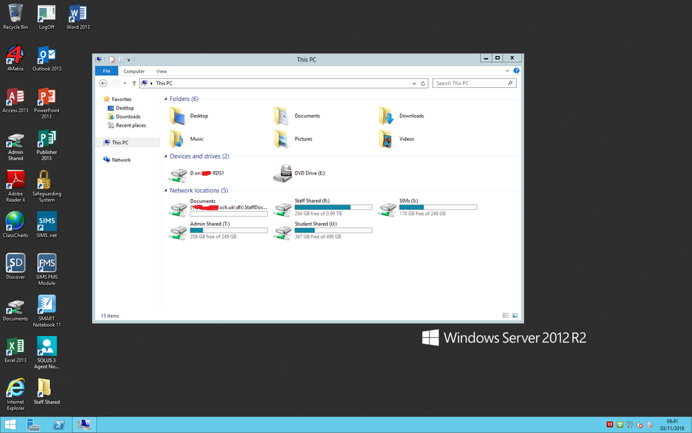

btw you might find it useful to also just add a RDP option to the server :p We have them all mapped individually, then the option that one of the programs RDPS into the server for a full login session so they get their normal desktop etc :p
See these pics for examples of ours - 1st is if you via the web way you can just open the drives directly, and 2nd is if you click the RDS1 option on our web
That might explain a bit better what I mean :)

The first screen shot is exactly what I am looking to achieve.
I have just made published explorer.exe to see if the GPO is working, and when I run it I can see the mappings on a non domain PC, so the GPO is applying correctly.
Almost there I think!
Thanks for the help Steve
Job done!
Mappings in place, folders and icons in place and everything seems to be working correctly.
Thanks to everyone that offered advice and help :)
