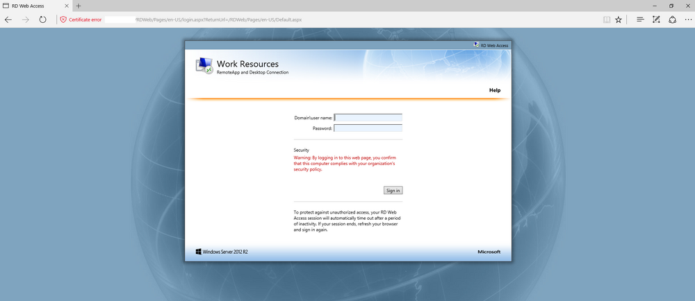

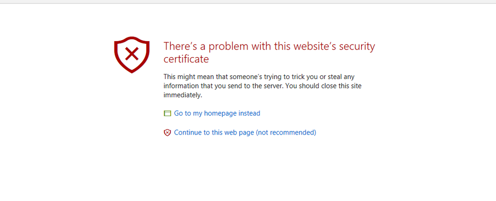

Hi Steve
So I did a few tests from home and after the certificate install yesterday the remote Apps no longer work.
Here are some screen shots.
This is the first error that comes up when you try to access the page. The same happens on chrome.
This is me ignoring the warning and navigating to the page. Note the certificate error in the taskbar
Error 3 is what comes up after yesterday's cert install that now prevents Remote Apps working correctly.
The final screen shot shows the cert trusted and installed on the remote App internal server

Not sure if you just changed something, but your domain is redirecting to an IP address which won't work. As the cert isn't valid for the IP address. Thus the error as it's a mismatch between the address "remote." and what's actually being returned "31...."
Steve
to get it to work externally you need to port forward port 443 from whatever your external ip is to your internal but the server needs to be "visible" as name.domain.com or the certificate wont match the address and it will not work (or i could just install googles certificate on mydodgysite.com
