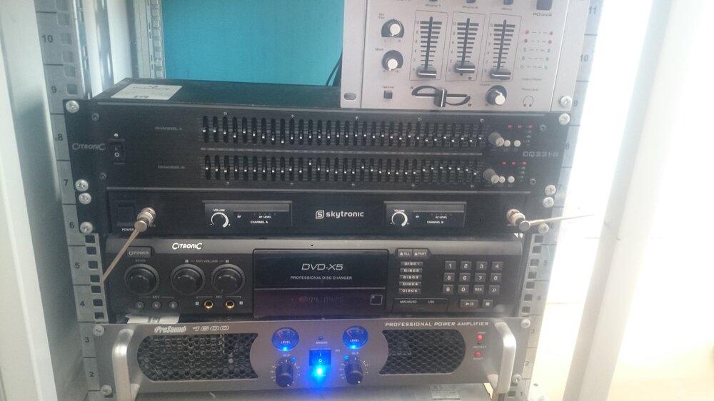

Thanks for the help. I do think that there's too much input signal from somewhere - but the temp light being always on threw me. But I guess it would be on right away as soon as the system is turned on the signal is there:
here'DSC_0463.jpgs a pic
Looks to me like you have a peak signal going through both left and right channels
Are you sure it's all connected nicely?
Also is that cd mixer at the top the only one or do you have a main mixing desk?
Thanks, that sounds feasible. As the cabinet all this sits in is bolted to the wall it's hard to make out what goes where. I'm just support the primary as a favour so no idea if anyone has tinkered with it, but they reckon it;s not been touched. hmmmmm.
Looks like I'm going to have to get my hands dirty and redo the wiring.
