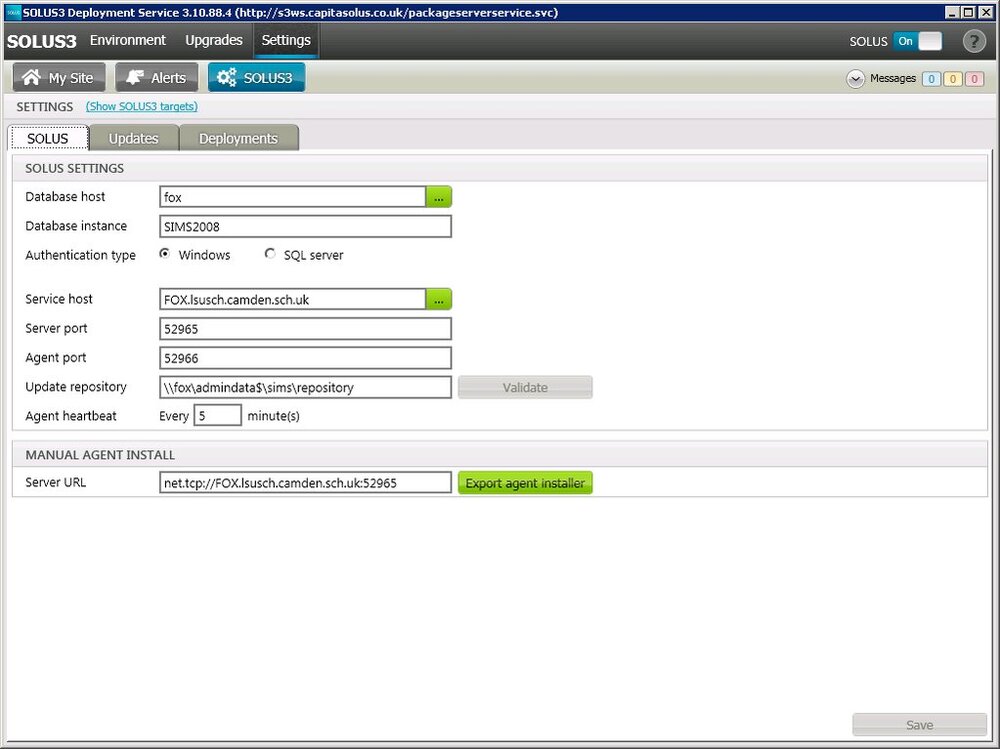

Hey Steve,
Please see attached.
Also, has the solus agent started on the workstation which is having issues?
Edited by mukz
Hey Steve,
Mmm strange, looks same as ours just without FQDN :s Just don't see where the clients get the information that points to server unless it's hidden registry wise. Thank you for that though appreciated.
