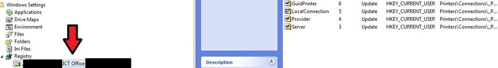

In our case Printers are deployed to OU's (rooms) which contains computer objects, and in that room is also the printer.
My user policy is linked to that computer ou with e group policy merge loopback.
Returned to the original gpo's and its now reverted back to the original issue of missing after every 2nd !
It must be something regarding the removal of profiles but why every other time, even after deleting the profile manually everytime makes no sense as we have profiles set to automatically delete after 1 day.
