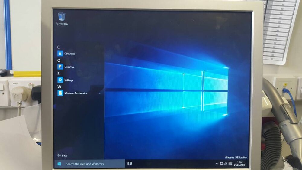

timbo343 Posted May 27, 2016 Author Posted May 27, 2016 @timbo343 I'm using delprof2 on a startup script to bin these tile datalayer folders. I was running side by side enterprise LTSB & Education side by side and i was unable to get rid of ALL the bloat. I was left with store & Xbox that i just couldn't get rid of. Im pressing on with LTSB using delprof2 to flush the profile folders each day until this issue is fixed Heres win10 education with all bloatware removed. Just need to disable settings now. Its only taken an hour and documenting it all.
Arthur Posted May 27, 2016 Posted May 27, 2016 Just need to disable settings now. That should only take a few minutes. www.edugeek.net/forums/windows-10/158751-settings-app.html#post1359458

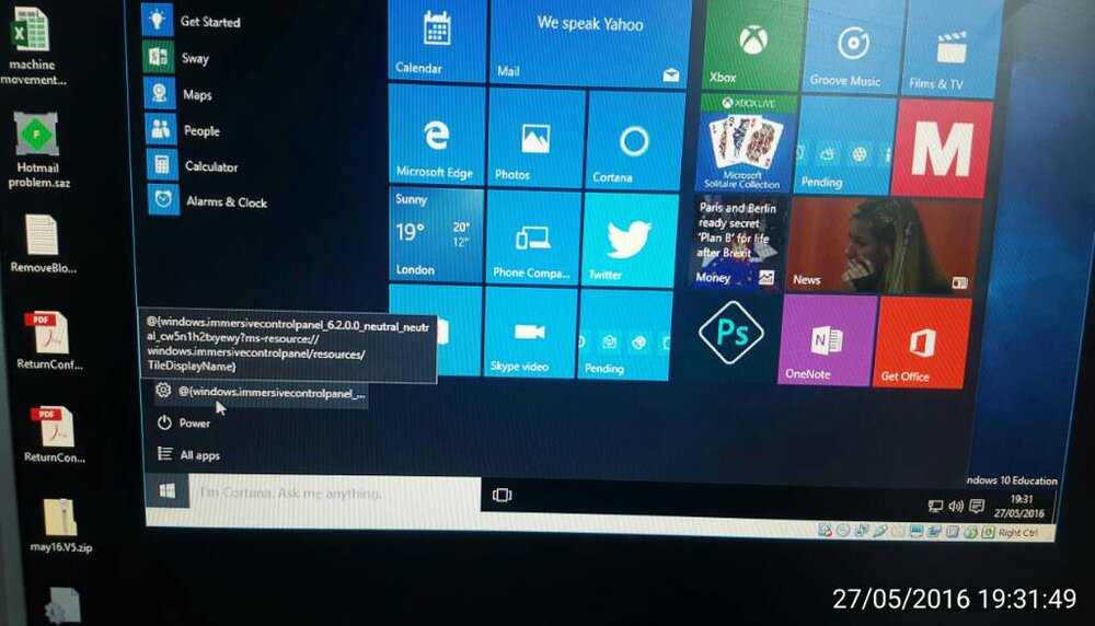

timbo343 Posted May 27, 2016 Author Posted May 27, 2016 ive managed something somewhere that makes settings not even open, if flashes up for a nano second then just disappears. I think its in GP somewhere If you can dig it out i'd be happy to have a look. I have renamed ImmersiveControlPanel Folder in C:\Windows. That disables settings but gives settings a stupid reference name like @{microsoft.immersivecontrol.....
timbo343 Posted May 27, 2016 Author Posted May 27, 2016 ive managed something somewhere that makes settings not even open, if flashes up for a nano second then just disappears. I think its in GP somewhere I've just thought, why don't i disable access to the folder for STAFF and PUPILS... that would be the logical option for now.
timbo343 Posted May 27, 2016 Author Posted May 27, 2016 I've just thought, why don't i disable access to the folder for STAFF and PUPILS... that would be the logical option for now. This is what happens when you prevent access to the immersivecontrolpanel folder...

timbo343 Posted May 27, 2016 Author Posted May 27, 2016 i've achieved the attached with a GPO. Ive not used any custom ADMs so its one/many of the stock GPOs [ATTACH]37054[/ATTACH] Ive just found another way, DENY access to the systemsettings.dll for staff and pupils. It flashes up but thats it.
stgoodyeara Posted May 27, 2016 Posted May 27, 2016 Ive just found another way, DENY access to the systemsettings.dll for staff and pupils. It flashes up but thats it. user setting --> admin templates --> control Panel --> prohibit access to control panel and PC settings
timbo343 Posted May 27, 2016 Author Posted May 27, 2016 user setting --> admin templates --> control Panel --> prohibit access to control panel and PC settings Oh, it must already be set in my GP. Im testing with local users at the moment, thank you.
