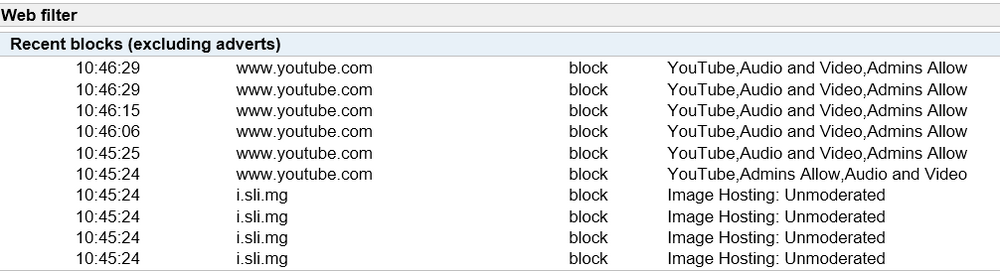

Unless you are using a different Smoothwall system to us (which is highly likely), when you first log in to the admin portal there should be a section showing Recent Blocks, like this:

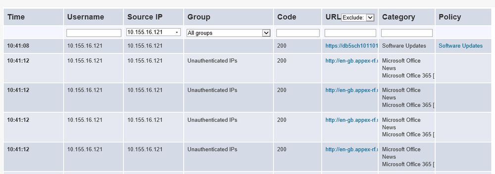

If not, go to the web filter logs and check there. You can search it by time and IP address to narrow it down. This will show you any blocked URLs that you can add to your list of allowed content.
