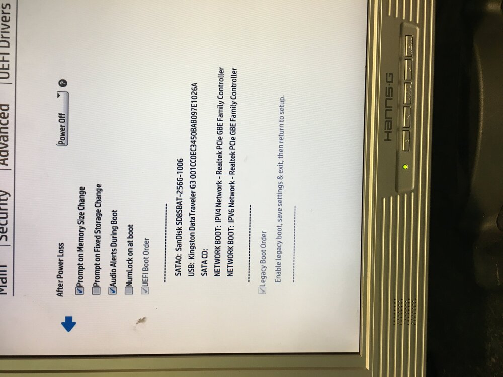

0 Neutral

  4. Hi All I have seemed to fix the issue. It was very frustrating as it was so simple. [TABLE=width: 100%, align: center] [TR] [TD=width: 768][TABLE=width: 100%, align: center] [TR] [TD=class: small]The issue was when enabling legacy support and saving the pc would restart and a code is required. before typing in the code you have to press NUM LOCK and then proceed to type in the code. Thank you all for your help and suggestions.[/TD] [/TR] [/TABLE] [/TD] [/TR] [/TABLE] [TABLE=width: 100%, align: center] [TR] [TD=width: 768][TABLE=width: 100%, align: center] [TR] [TD=class: small][/TD] [/TR] [/TABLE] [/TD] [/TR] [/TABLE]
  5. Hi all, Thank you all for your responses. I have tried everything that has been listed. When I do change anything from the bios, upon restart i type in my code to confirm this and go back into the bios to check if I can then enable legacy support but it appears to be that everything is just changing back. I will Enable legacy and disable secure boot onces the pc restarts to process change it changes back to legacy disabled? Would there be something else in the BIOS that is preventing the Legacy support to be enabled?

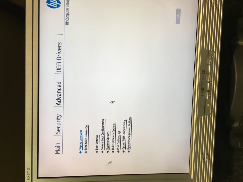

  6. Tom I have attached some photos with some options I have. Also the Legacy Boot Order is has a tick in the box but it is greyed out I will attach photos.
  7. Hi Tom, After enabling Legacy support I am still unable to boot to windows 7. Hi Boot, We unfortunately don't have windows 7 on a flash driver. Do you know where I can get this from via the rm website?
  8. Hi, Once we PXE boot the only available boot option we have are for windows 8.1 only.
