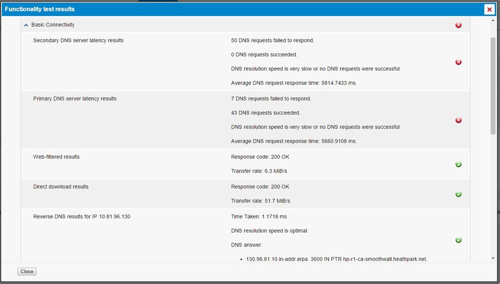

I ran a functionality test on Smoothwall (built in network testing tool) and here were the results which I thought were quite alarming..
(attached the screenshot)
Both the council and smoothwall are now investigating this problem as to what it could be, I did update Smoothwall recently but nobody else seems to have experienced any problems like this since the update. The council got me to setup up a laptop in our server room that goes directly to there HP 5800 switch which then bypasses Smoothwall, and the internet is spot on when you bypass Smoothwall.

We had the same issue when we moved to a new bb provider ours turn out to be the winhttp settings clients.
But we also found out that the DNS forwarders need to be on the AD DNS and not the SMoothwall and that fixed it for us within 20mins
Stuart
