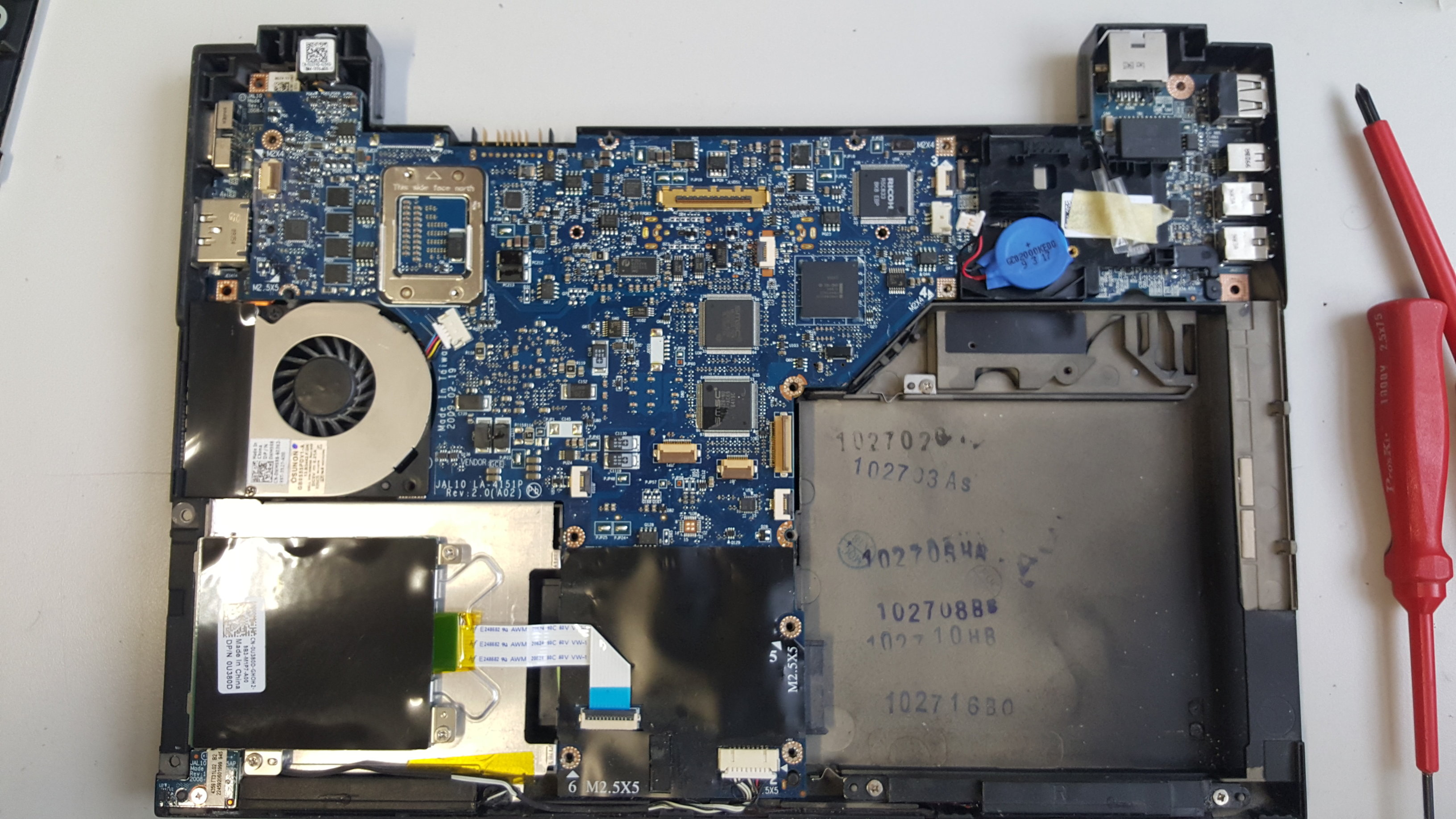

timbo343 Posted March 22, 2016 Posted March 22, 2016 A user has brought me a Dell E4300 laptop which wont boot. What i mean by "wont boot" is it wont get past the Dell Bios screen. Its got the small blue bar stuck at about a 10th of the way across. What i've tried: Removed HDD, Removed CD Drive, Removed, WLAN Card, Removed Battery (its powered via PSU), Swapped Ram with another E4300 which works, Removed Keyboard, Unplugged CMOS Battery, Powered on without battery in or plugged into mains to "reduce static" and it still doesn't boot. Is there anything that i've missed?

timbo343 Posted March 24, 2016 Author Posted March 24, 2016 Slightly different instructions here https://www.bios-mods.com/bios-recovery/insyde-bios-recovery/ The instructions on the site dont work. Im trying the WindowsKey and B but it just hangs at where its been hanging for the last couple of days. I think i'm going to look at replacing the BIOS chip, if i can find it.
difinity Posted March 24, 2016 Posted March 24, 2016 Possibly on a plug in board. Dell Latitude E4300 Bios Chip JX186 - LS-4157P | eBay 1
timbo343 Posted March 24, 2016 Author Posted March 24, 2016 (edited) Possibly on a plug in board. Dell Latitude E4300 Bios Chip JX186 - LS-4157P | eBay Im trying to find it and not having much luck ?? Im going to ring @ICTDirect_Dave to see if he has had any problems with them. Edited March 24, 2016 by timbo343
Joanne Posted March 24, 2016 Posted March 24, 2016 Dell motherboards are WELL CHEAP on ebay. I replaced one last week. Just triple check it's exactly the same though! DELL LATITUDE E4300 MOTHERBOARD 2.26GHz CPU DELL P/N UX187 TESTED OK ref ax23 | eBay 1
