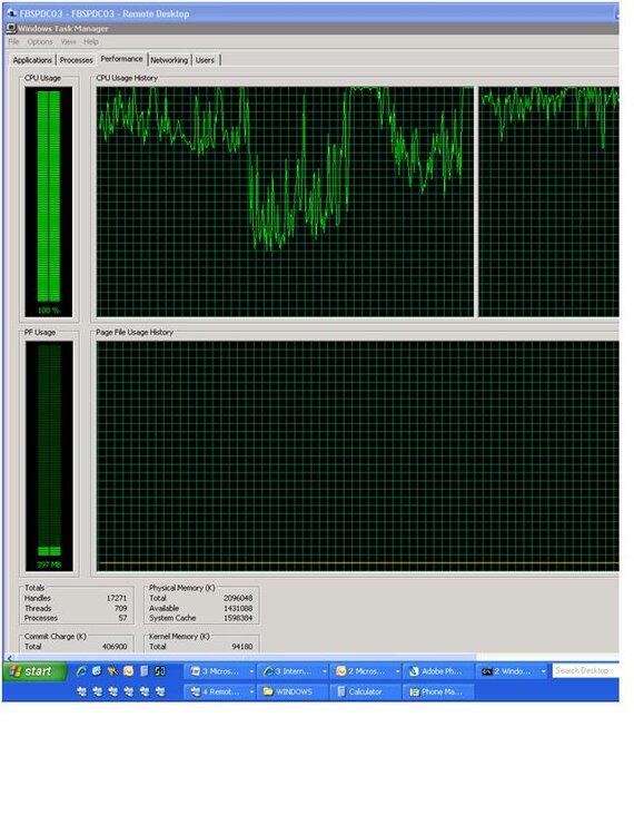

Looking at your screenshot you're running 57 Processes and using around 700 - 800MB of memory (which is quite normal). It doesn't look like you have a memory leak.
If you open up My Computer and choose 'Help > About Windows' what Service Pack do you have installed? It should be Service Pack 2. If you are already running 2003 Service Pack 2, run Windows Update as there are quite a few post hotfixes. Make sure you reboot after applying all fixes!
Although Sophos is known to cause a little slow down on machines with low memory (256-512MB) I don't genuinely believe Sophos is the problem of your slow down.
