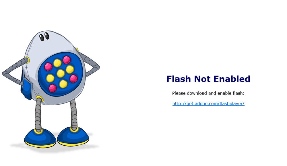

We have recently been testing out windows 10 on our CC4 school network and have run into a issue with the built in flash player on Internet explorer 11 and Microsoft edge.
We are getting errors from sites such and My Maths where it says that flash is not enabled.
I have checked the managed add-ons for the browser and it says its enabled.
I have tried ActiveX filtering on and off but no luck and was wondering if anyone has run into this issue or can shed some light.
Thank you :)
Try going into Developer tools in IE (hit F12) and go through the options at Emulation > User agent string. I guess it's possible that MyMaths does not recognise Edge as a browser that would have flash - tricking it to think its another browser might do the trick.
Thank you, unfortunately that didn't work. This issue isn't just isolated to My maths even on the adobe website to test the flash it says its not enabled.
