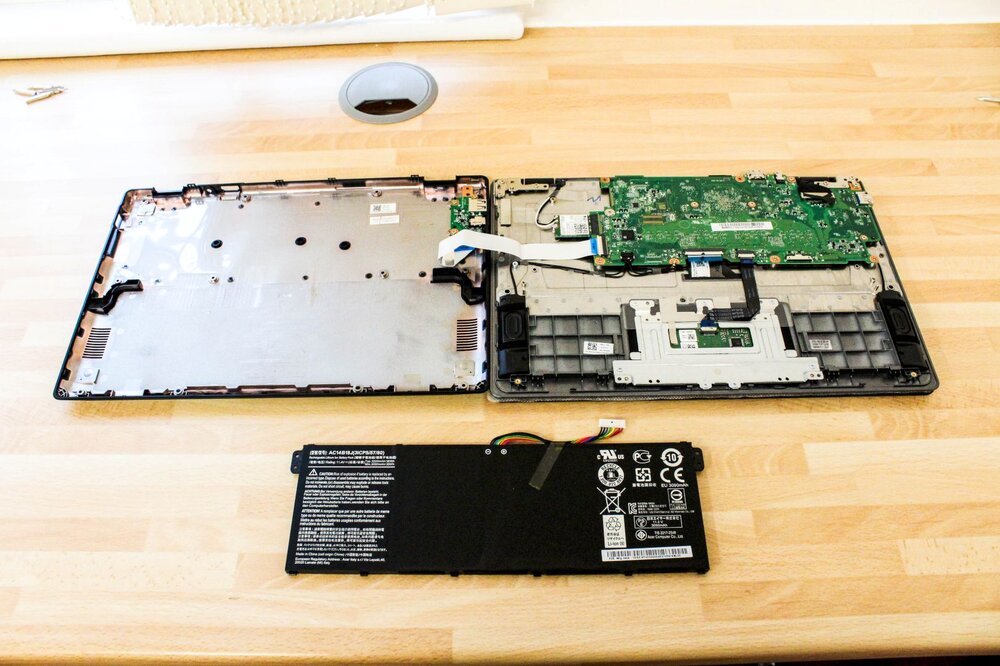

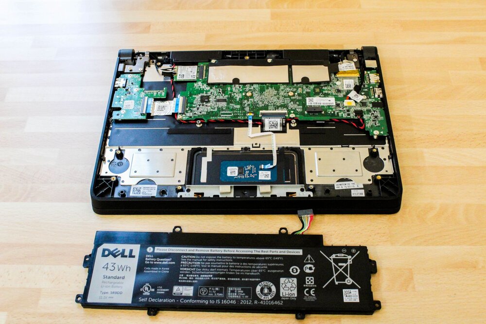

I'm currently running a Chromebook trial to assess their viability to replace our aging Netbooks and IT Suite. Number one on my list of priorities is also the longevity of the devices. So far I have had units from Lenovo, HP, Acer and Dell. All have had user replaceable batteries. Here is an example of the Dell Chromebook 11 & Acer Chromebook 11
Warranties however vary wildly. So far Dell has the best offering with a 4y NBD Warranty available, although no battery option like their Latitudes.
