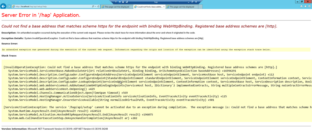

Hi I am having some trouble with installing HAP+ 10 (HAP+ Web Core v10 Full).
The server is new/blank and I followed your video guide (https://www.youtube.com/watch?v=LCL3Tj55ns0) four times and I just cannot get it to work correctly (or even at all).

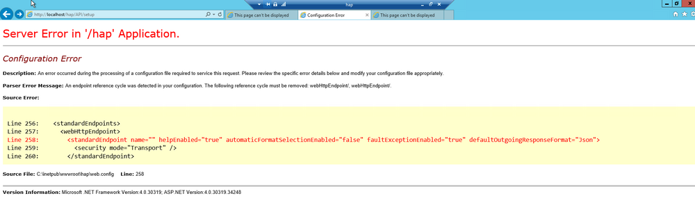

My ending result is that I get the error before you edit the Web.config I get the error like in your video guide I do changes again as shown, refreshing will bring up the HAP+ setup page but the 'Services Activated' has a cross. If I try and got to the link 'http://localhost/hap/' that does not work and putting the actual local host name does no work either.
Trying to get to the http://localhost/hap/API/setup or http://localhost/hap/API/setup/help I get Server error, I have screen captured the errors and copied text to notepad but I have noticed the errors switch between themselves depending what page you are on or refreshing etc.
I have noticed that everyone else uses https:// but this does not load any of the pages up, the set up page only works as a http://

Server error API-Setup-help.txt
Server error API-Setup.txt
