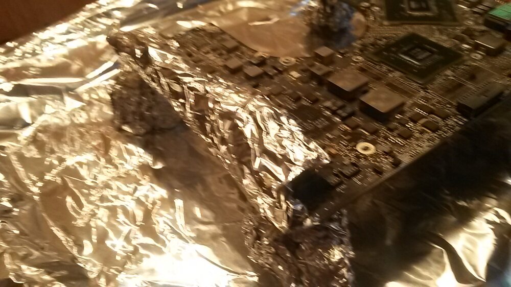

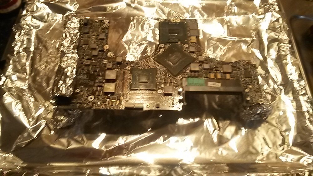

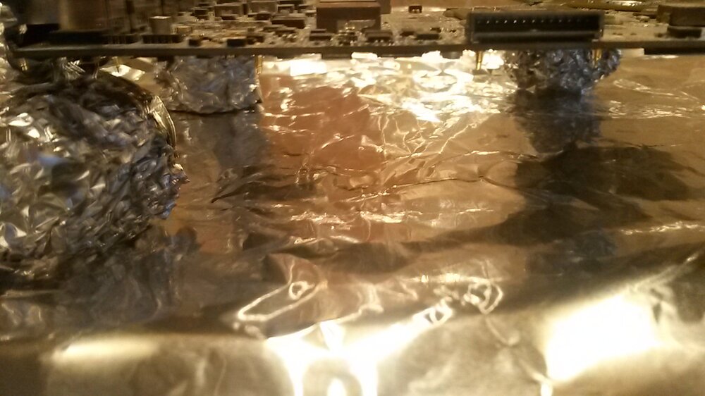

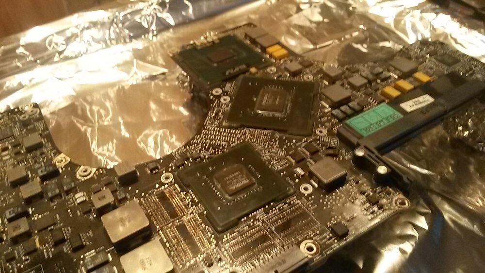

Since the board is knackered anyway, why not try a home reflow?
I did this with my 2009 mbp and it worked a treat for another year before it was replaced.
Pull the mobo, cover the ports with some foil so they don't melt, place it on some kitchen foil pillars on a baking tray and bake for 12 minutes at 190c.
It might be just the thing you need, and if it doesn't work, well it was knackered anyway so you've not lost anything and have had a bit of an adventure :)

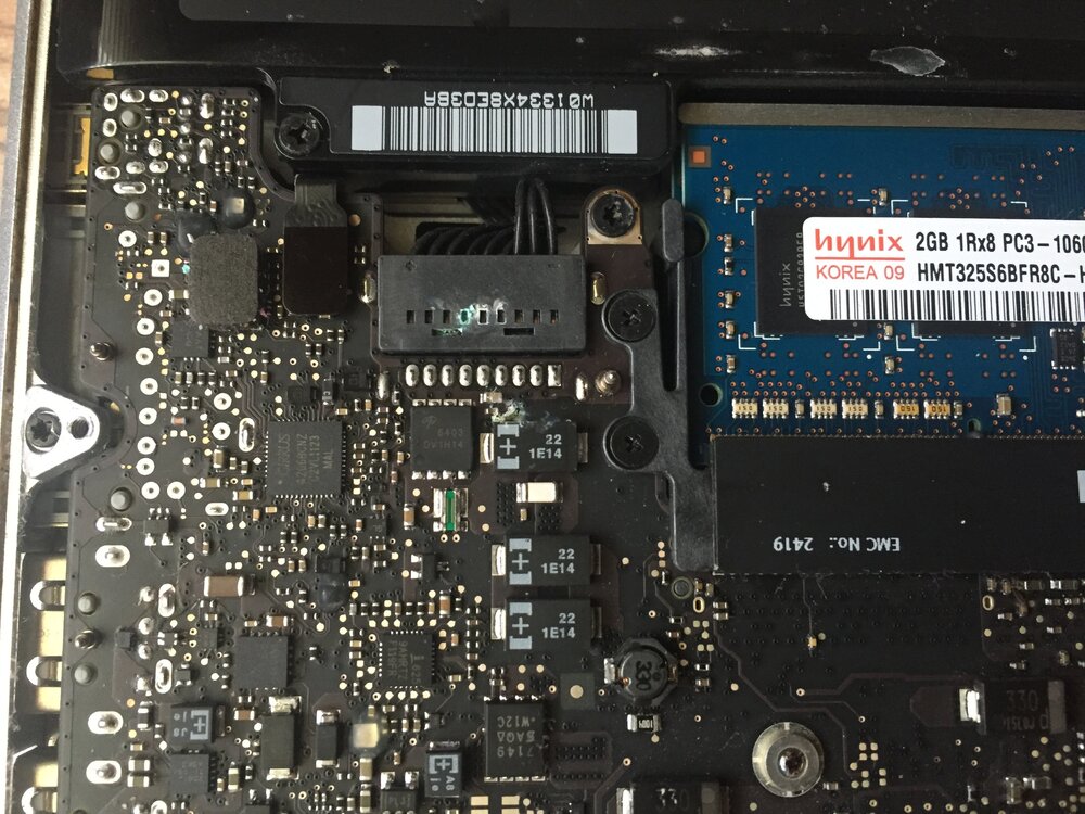

Crikey Dave, that's a new one on me! Not sure if it will help as I did inspect it before it went off to Apple and I suspect it has got water damage, though the user doesn't seem to think so.
If you take a look at this image, there is definitely some abnormal discolouration by the battery terminal and some capacitors below...
