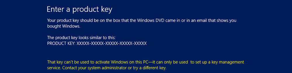

Sagima Posted October 21, 2015 Report Posted October 21, 2015 I've done the schema upgrade, now on version 69 (lol) but now I'm getting a different error when trying to set up volume activation services. [ATTACH=CONFIG]32847[/ATTACH] I has a sad. My first two thoughts would be you either haven;t installed the role or you still have a mak installed on the server you want to be a kms server (as it needs to have its kms key - the public one for clients)
Joanne Posted October 21, 2015 Author Report Posted October 21, 2015 Brand new install, no keys installed. Role installed was 'Volume Activation Services'. I'm doing everything through the VA wizard.
Sam_Brown Posted October 21, 2015 Report Posted October 21, 2015 Brand new install, no keys installed. Role installed was 'Volume Activation Services'. I'm doing everything through the VA wizard. Tried turning it off and on again... >_>
Joanne Posted October 21, 2015 Author Report Posted October 21, 2015 Hahahah! Getting this now: Might have to do it the old fashioned way at this rate...
