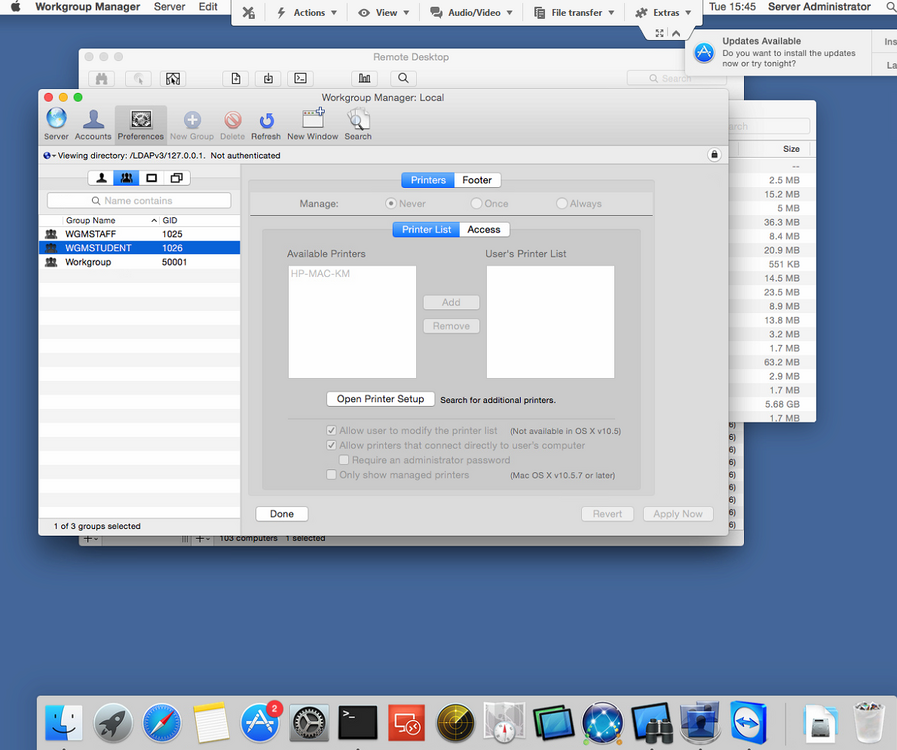

[ATTACH=CONFIG]32370[/ATTACH]
Any ideas why this is greyed out?
Use the lock on the top right to unlock it to have access to editing your settings. That said, if you are connecting to another directory and not the OD on the server then you may have issues saving changes.
