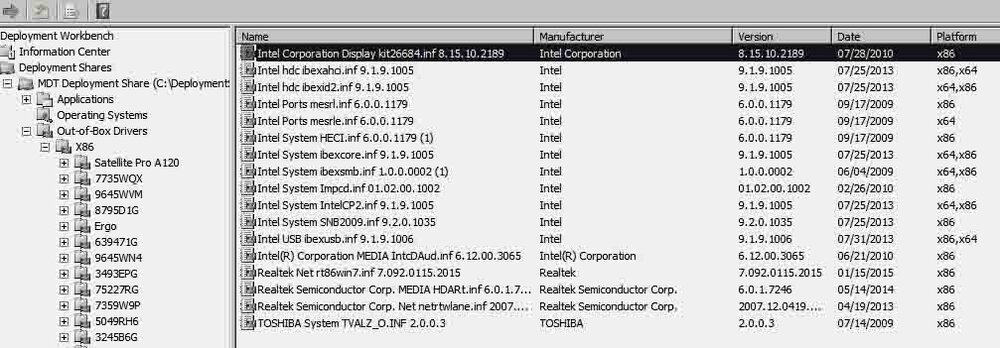

I'm having an issue with an incorrect driver version being used when deploying an image with MDT. I have drivers segregated into models and use the DriverGroup001 variable to force model selection in the TS. I can see the correct drivers and correct driver versions being copied over in the driver injection stage however when the imaging is complete the wrong version is installed for a particular device for which I have specified an older driver.
As you can see in the image attached, the version of ibexsmb.inf being used is the much older version 1.0.0.0002 to solve an issue which I believe is being caused by driver version 9.1.9.1005 (which the core devices use). When sysprep is completed however, the driver version being used is the newer 9.1.9.1005 which is not in the drivers forced on the system.
Any idea why this may be happening?
