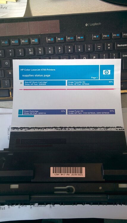

Interestingly, jammed halfway through printing the supplies page, and it looks fine (other than no black at all) as it enters the Fuser, and the covered in Black straight after.
Might be worth trying a different fuser. Will be a pain if it is though, don't remember them being cheap, but at least it's an easily changeable part.
[ATTACH=CONFIG]30803[/ATTACH]
Can you see any damage or burning on the fuser roller
