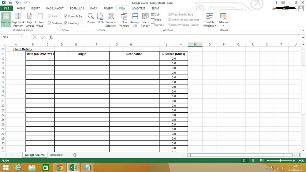

So I've got that working - the only issue is it copies the contents of the cell too, so I've decided that if I can use this, but insert cells from another worksheet then perfect! I've tried adapting it, and it ran with no errors, just didn't insert any rows... any idea how I'd go about doing this with the code?
Appreciate all the help!
I thought you wanted the contents copied across
I do, but only some of them have the forumlas...
it looks like this:
There are two hidden columns, the Mileage columns has the GMaps formula, and the Origin and Destination contain drop down menus of different sites. Does that make sense?
