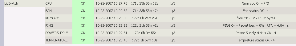

Lee_K_81 Posted December 17, 2007 Posted December 17, 2007 I'm not very experienced in Nagios, or Linux for that matter so hopefully somebody can help me. I've setup a Linux Ubuntu VM. Installed and configured Nagios and it's currently nicely monitoring my windows servers, but i want to it monitor the infrastructure too. I'm starting with a HP Procurve 2650. I've managed to get the a ping monitor working but i'm lead to believe that you can also monitor bandwidth usage, CPU, memory temp, uptime, etc. Here's what i have in my switch.cfg file: # Create a service to PING to switch - this one works define service{ use generic-service ; Inherit values from a template host_name SvrRoom_Cab2_SW1 ; The name of the host the service is associated with service_description PING ; The service description check_command check_ping!200.0,20%!600.0,60% ; The command used to monitor the service normal_check_interval 5 ; Check the service every 5 minutes under normal conditions retry_check_interval 1 ; Re-check the service every minute until its final/hard state is determined } # Monitor uptime via SNMP define service{ use generic-service ; Inherit values from a template host_name SvrRoom_Cab2_SW1 service_description Uptime check_command check_snmp!-C public -o sysUpTime.0 } # Monitor Port 1 status via SNMP define service{ use generic-service ; Inherit values from a template host_name SvrRoom_Cab2_SW1 service_description Port 1 Link Status check_command check_snmp!-C public -o ifOperStatus.1 -r 1 -m RFC1213-MIB } # Monitor bandwidth via MRTG logs define service{ use generic-service ; Inherit values from a template host_name SvrRoom_Cab2_SW1 service_description Port 1 Bandwidth Usage check_command check_local_mrtgtraf!/var/lib/mrtg/192.168.1.253_1.log!AVG!1000000,1000000!5000000,5000000!10 } define service{ use generic-service host_name SvrRoom_Cab2_SW1 service_description Memory is_volatile 0 check_period 24x7 max_check_attempts 3 normal_check_interval 5 retry_check_interval 1 notification_interval 60 notification_period 24x7 notification_options c, r check_command check_hpmemoryfree!2000:19000000!1000:19000000 } define service{ use generic-service host_name SvrRoom_Cab2_SW1 service_description CPU is_volatile 0 check_period 24x7 max_check_attempts 3 normal_check_interval 5 retry_check_interval 1 notification_interval 60 notification_period 24x7 notification_options c, r check_command check_hp_cpu!95:90!100:95 } define service{ use generic-service host_name SvrRoom_Cab2_SW1 service_description PowerSupply is_volatile 0 check_period 24x7 max_check_attempts 3 normal_check_interval 5 retry_check_interval 1 notification_interval 60 notification_period 24x7 notification_options c, r check_command check_hppower!4!3:5 } define service{ use generic-service host_name SvrRoom_Cab2_SW1 service_description Temperature is_volatile 0 check_period 24x7 max_check_attempts 3 normal_check_interval 5 retry_check_interval 1 notification_interval 60 notification_period 24x7 notification_options c, r check_command check_hptemp!4!3:5 } define service{ use generic-service host_name SvrRoom_Cab2_SW1 service_description Fan is_volatile 0 check_period 24x7 max_check_attempts 3 normal_check_interval 5 retry_check_interval 1 notification_interval 60 notification_period 24x7 notification_options c, r check_command check_hpfan!4!3:5 } In my commands.cfg file i have: #'check_hpmemoryfree' commnand definition define command{ command_name check_hpmemoryfree command_line $USER1$/check_snmp -H $HOSTADDRESS$ -C $ARG1$ -o .1.3.6.1.4.1.11.2.14.11.5.1.1.2.1.1.1.6.1 -w $ARG2$ -c $ARG3$ -u bytes -l free } #'check_hptemp' commnand definition define command{ command_name check_hp_cpu command_line $USER1$/check_snmp -H $HOSTADDRESS$ -C $ARG1$ -o .1.3.6.1.4.1.11.2.14.11.5.1.9.6.1.0 -t 5 -w $ARG2$ -c $ARG3$ -u % -l '5min CPU' } #'check_hptemp' commnand definition define command{ command_name check_hpfan command_line $USER1$/check_snmp -H $HOSTADDRESS$ -C $ARG1$ -o .1.3.6.1.4.1.11.2.14.11.1.2.6.1.4.1 -w $ARG2$ -c $ARG3$ -l 'Fan Status' } #'check_hptemp' commnand definition define command{ command_name check_hppower command_line $USER1$/check_snmp -H $HOSTADDRESS$ -C $ARG1$ -o .1.3.6.1.4.1.11.2.14.11.1.2.6.1.4.2 -w $ARG2$ -c $ARG3$ -l 'Power Supply Status' } #'check_hptemp' commnand definition define command{ command_name check_hptemp command_line $USER1$/check_snmp -H $HOSTADDRESS$ -C $ARG1$ -o .1.3.6.1.4.1.11.2.14.11.1.2.6.1.4.4 -w $ARG2$ -c $ARG3$ -l 'Temperature Status' } The info on monitoring HP switches i got was from here: http://www.nagiosexchange.org/Wiki_Home.wiki.0.html?&tx_drwiki_pi1%5Bkeyword%5D=HP%20Switches Has anybody successfully got Nagios monitoring their HP switches? thanks in advance.

Lee_K_81 Posted December 17, 2007 Author Posted December 17, 2007 My point is that sometimes it can be a tad difficult to use, or at least to set-up / configue an app. If something is easy to use, it's inherently less powerful. Take your pick. doesn't manage to get a connection. I'm assuming it's to do with the proxy settings. We've discussed proxy issues under Linux and specifically with apt on several occasions. Here's a thread on the subject. http://www.edugeek.net/index.php?name=Forums&file=viewtopic&t=7690 it seems to be a dependancy prob If you fix your proxy problem and use apt-get or preferably aptitute. These will sort your dependacy problem out. If all else fails, remove nagios-plugins-extra and start again. By time i read this comment i'd removed the nagios-plugins-extra and that worked out ok, i must be getting a little better maybe. I just copied the check_snmp into the libexec folder and it works. I am getting an Unknown status and no data recieved from device but atleast i'm reaching the device. Thanks for all your help.
Lee_K_81 Posted December 17, 2007 Author Posted December 17, 2007 All sorted. Prob was with the SNMP community string. I now can see lots of green which is always good. Thanks for the help.

sno Posted September 10, 2009 Posted September 10, 2009 Is there an explanation anywhere for the values reported by the swichtes, for example: Temperature: 4 Power Supply status: 4 Fan Status: 4 CPU: 5
