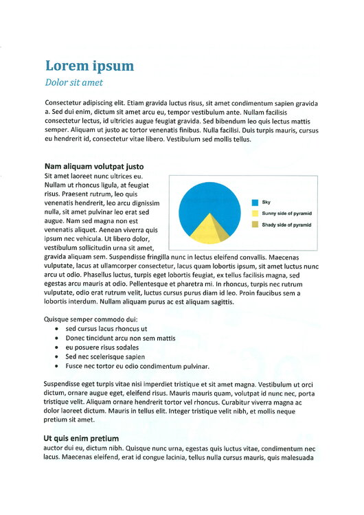

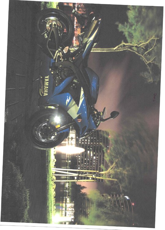

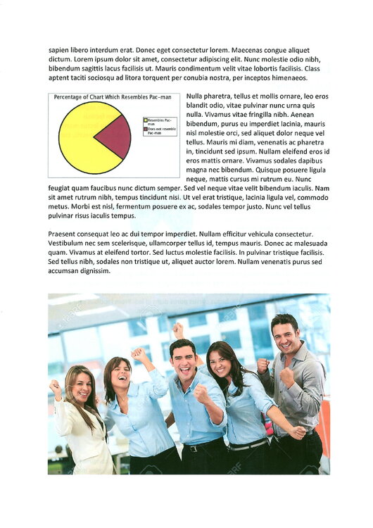

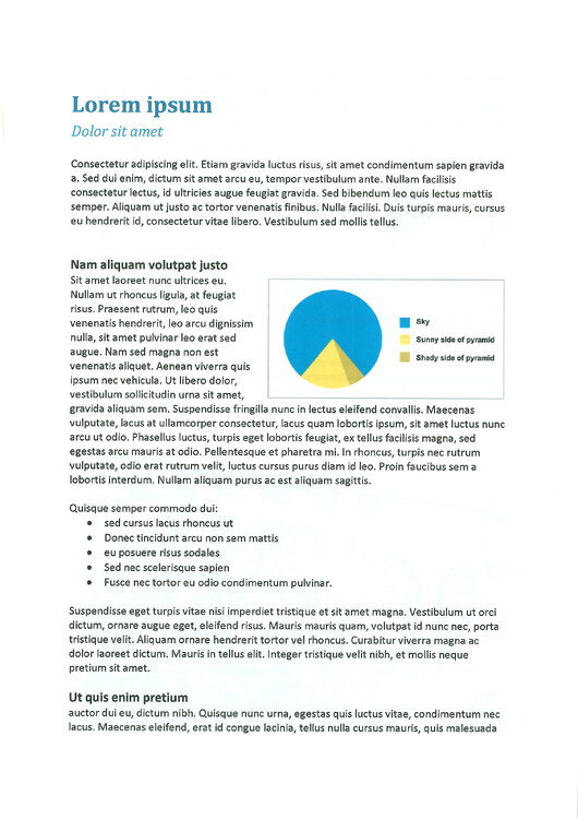

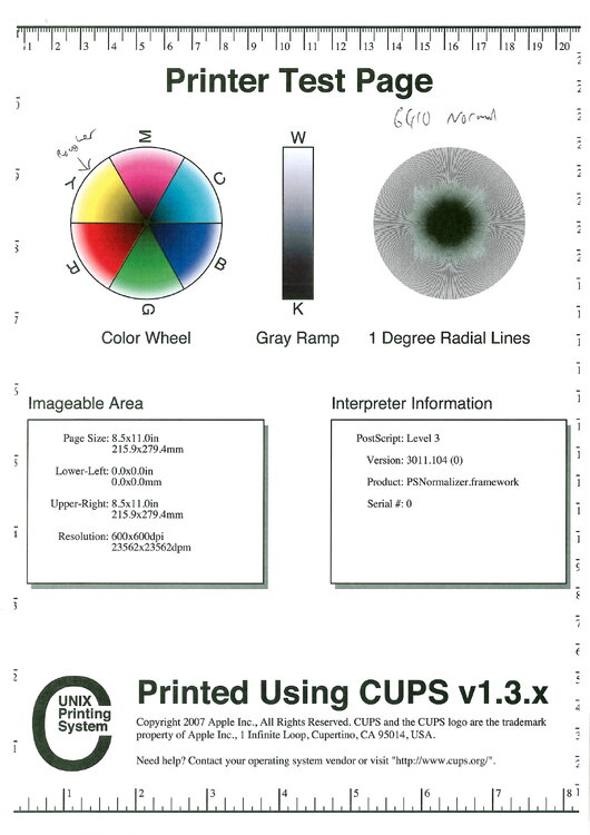

DCUK6 Posted May 21, 2015 Posted May 21, 2015 What are they like on a full page photo? (high res) Original Draft (General Office) Professional presentation The scans look a tiny bit fainter than they actually are but not far of. Lasers are alot better on pictures. Not a printer to be doing your newsletters etc on, more just detention letters with a school logo. As you can see, its a nightmare trying to get it to scan straight on individual sheets, and weve had one jam in 746 pages. 2

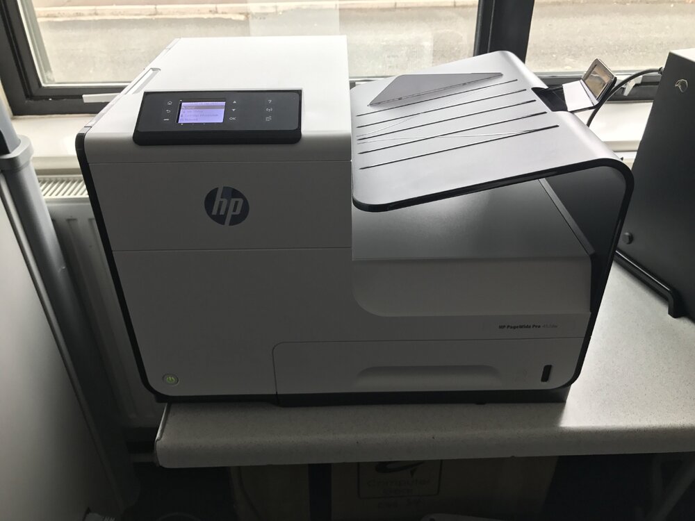

newpersn Posted September 15, 2017 Posted September 15, 2017 Bit of bump. Just brought one to play with. HP PageWide Pro 452DW. Ink is same as a Brother HL-L8250 costs but get more to a cart. Brother was 4000 black and 3500 CMY. HP XL 10000 black and 7000 CMY. For the same price. It's quicker. Better looking. I like it.
