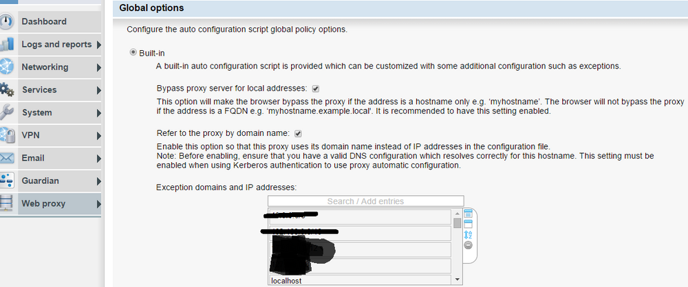

No worries , My thoughts are smoothwall related too because if i change disable the proxy it works fine. The default gateway is set to the gateway of that Vlan Depending on which Vlan they are in as they have been done by location. The client and the server are in different Vlans. I have not tried the HTTP option yet but will give it ago shortly. The issue is once the teacher gains access to the email its fine so i have to find someone having the issue.
smoothwall is configured to carry out HTTPS inspection and is configured with an upstream proxy. Ill try accessing OWA form the same VLAN and see what happens.

So the smoothwall is either trying to forward your FQDN to your external NAT address or something is wrong with the HTTPS inspection.
out of interest do you use the smoothwall's "automatic configuration" setting ?
(web proxy > automatic configuration )
yes please add the FQDN , IP and NETBIOS name of your exchange server,
if i was a betting man i am usre this will resolve your problem .
