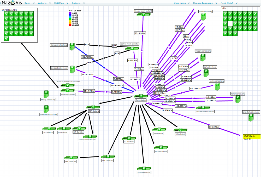

Probably found one by now, but we use nagios (with Check_mk) to monitor switches, servers and WAPs. Then we use nagvis to make our network map. It is all done manually but just updated as part of our documentation changes whenever something is added/removed. If you spend some time with nagvis you can build yourself a nice little heatmap :)
As you can see ours is not quite there but hopefully should get this sorted by the end of the week.
edit: Just realised you are after a network scanner. Still once you know where everything is I found the best way to learn our network (been in post for 11 months) was to populate nagios and piece together the nagvis map. Good luck :)
