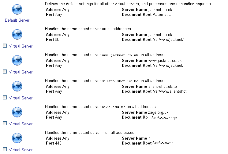

Jackd Posted November 30, 2007 Report Posted November 30, 2007 At the minute ive got a few problems with Apache2 running on Ubuntu server 7.10 First issue is that mod_alias has been uninstalled any ideas how i would re-install that. And second ive got mod_ssl installed and it seems to be working strangely. Heres my virtualhost for the site that i want setup DocumentRoot "/var/www/ssl" ServerName ssl.dzgforum.com allow from all Options +Indexes SSLEngine on SSLCertificateFile /etc/apache2/ssl/apache.pem The server does not seem to be taking the ServerName value because if i browse to https://jacknet.co.uk the site is displayed like it should be for that virtualhost i get the documentroot of that virtualhost and everything. But if i browse to https://ssl.dzgforum.com i get nothing just the page cannot be displayed. Any ideas? Thanks Jack Dunn

Joedetic Posted November 30, 2007 Report Posted November 30, 2007 Iain is right. You can't use name based vhosts with SSL. So your SSL vhost should be on a different port and the server name you give it is irrelevant because it'll be accessible on all domains that point to that server on port 443. Make sure that you've got 443 in your apache listen-on-ports file or whatever it's called. Make sure that you've got the NameVirtualHost *:443 HOST STUFF To get alias mod into mods-enabled directory you need to run the a2enmod command from within the mods-available folder (you'll need to use sudo) and then restart Apache. It's been a while since i used Ubuntu Server i will admit, I'm on FreeBSD for my servers now and it's got a different method for managing modules etc. under Apache.
Jackd Posted November 30, 2007 Author Report Posted November 30, 2007 I know about a2enmod but that says Module not avalible the mod was acting strange a bit ago so i disabled it but now when i try to enable it it says module not avalible Ive attached a screenshot of my VirtualHosts in webmin (purely because its easier to view). The site is still not working correctly like that, its still displaying on the site thats default jacknet.co.uk and not the site it should be ok on
