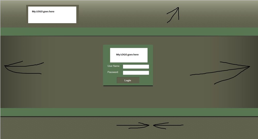

and heres the result: ( i have blanked off my logos)
i have drawn on black arrows to show the white and black grdients at the top and the sides also if you look the fine white diagonal strips on the top and bottom bands.
I want the whole thing in this colour #5F604C apart from the bold green strips and the logon box

Thanks LosOjos I have tried trial and error and just can't get rid of it, I have already tried what you sugested and what that does is change text color on the next page when you login from white to the dull green.
the webpage seems tobe transparent with white as the backdrop then layerd up in stages with the colours

DO you have a link to the web page that you could share?
Can you open it up in google chrome then right click on the background/affected area and inspect element that maygive you some more clues.
MattDLEA, thanks that pointed me in the right direction thanks - it loads PNG images from a folder within the site and these have gradients within them, I have managed to rstop the white lines it was a file called pinstripe.png i just renamed the file, refresh the page and gone site is looking better now still not managed to quite get them all but will continue tomorrow
