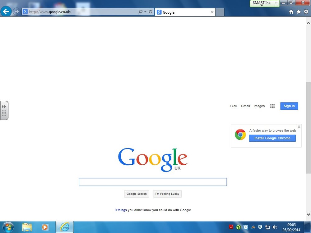

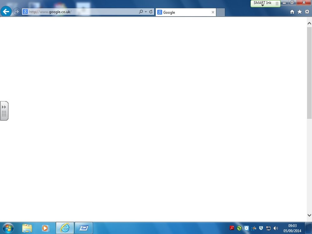

I have had this problem with Google home page for a while now and I'm scratching my head. keeping in mind its only happened since the install of IE11
various users around our school have reported that when they load "www.google.co.uk" from their IE11 browser. the home page loads up and then moves to the bottom of the page. they then try to click into the box where they search in Google and it doesn't do anything.
I have taken screen shots of the problem just to show you what I mean.
As far as I'm aware this has only happened since IE11 was installed and already tried to run IE11 without add ons and still the same results!
any ideas?

I've pushed out a package which simply deletes the "Smart INK" value from [HKEY_LOCAL_MACHINE\SOFTWARE\Microsoft\Windows\CurrentVersion\Run] - this stops it running at logon.

I can now confirm that Smart Ink was the problem!!
