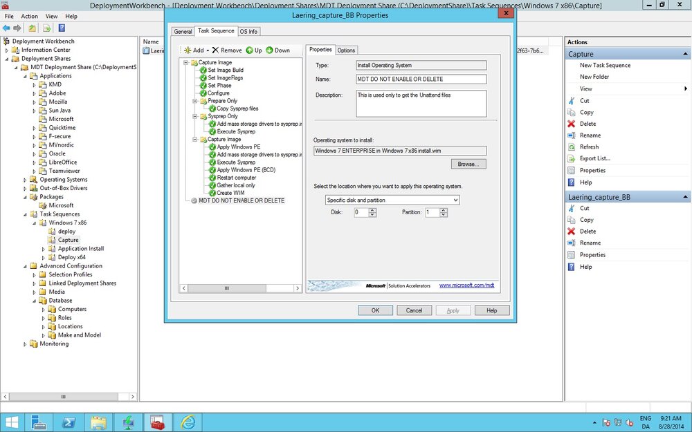

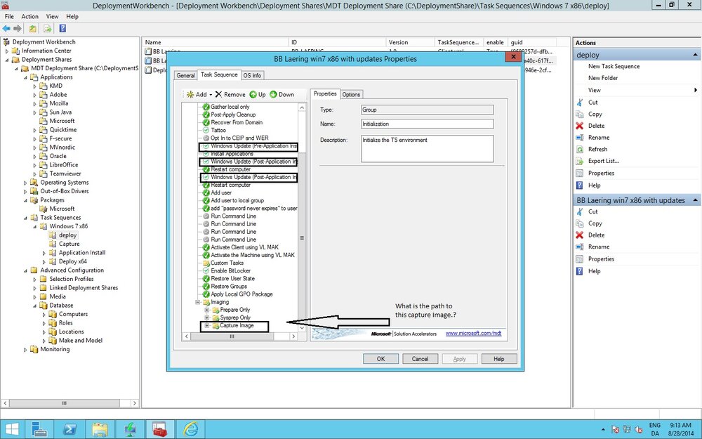

This is my deploy TS
My capture TS

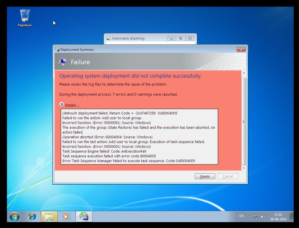

The "add user" is my bad.
But it still won't capture from a deploy TS.
I have to look at it again tomorrow. :(

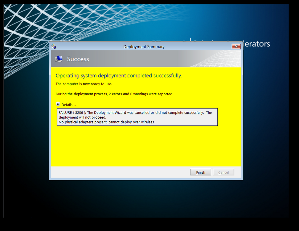

Finally I ended up with a capture.wim but this error turned up at the ended.?
Not seen that error before but just check through your customsettings.ini and make sure you've got no typos etc.

Ok, finally i got it to work.
It turned out that it was my own fault (what a surprise!! :S)
When I made the TS I used my captured image, BUT to save time I copied the TS (-control->TS.xml) from a already working TS and thus copying a another image (without the updates) into the new TS, and thus replacing the correct captured image, to a image without updates.
Yes, stupid! I know. :S
