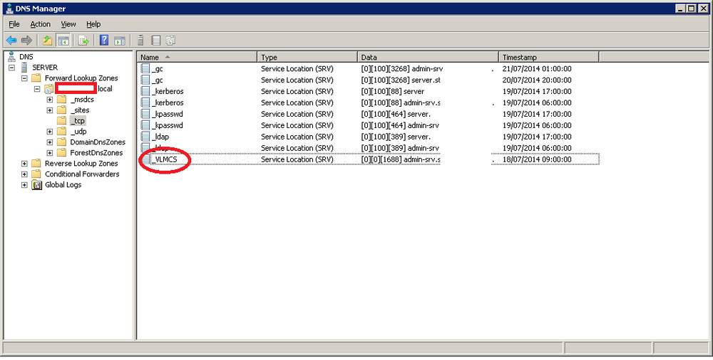

the KMS needs to have a static ip as there is an entry in DNS (srv _vlmcs record) if this IP isnt the same as your host clients wont be able to "find" the activation server.
check the DNS record matches your host.

no but your kms server needs a fixed ip as it dosent look at the pcs name it looks at the vlmsc part of dns and iirc that dosent update so even if kms-01 is pingable it wont work as a kms server on a new ip unless youi change the dns entry for it

Yeah it's in there. I have assigned it a static IP now. I've deleted the record of my old 2nd KMS. I don't have a machine to test on now...

[ATTACH=CONFIG]25808[/ATTACH]
