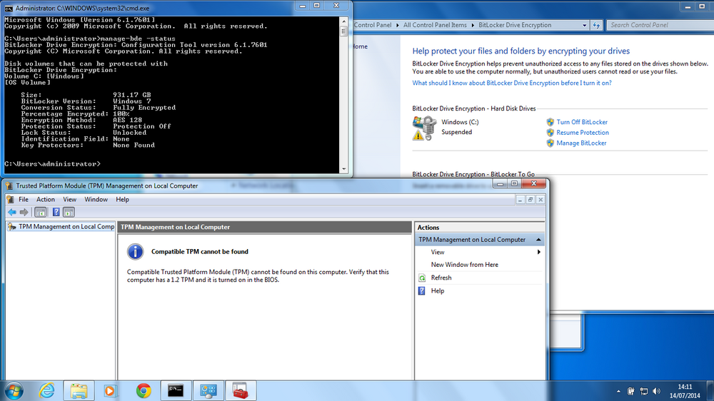

Nothings working for me :( even running the command manage-bde -tpm -turnon within windows with the infineon software installed doesn't detect a TPM module.
Interestingly though, the TPM chip appears in the system devices, but i thought the tpm chip would appear as it's own entity within device manager? I'm sure that's what i've seen before. I'm starting to think the TPM chip in these laptops is some cheap knockoff lol

Doesn't work using the wizard either, everything just tells me a compatible TPM module wasn't found.

Have you tried uninstalling the driver for the TPM under system and then let windows redetect. Had to do this on a load of Dells as Bitlocker really doesn't like 3rd party TPM driver. Once I did this it is shown as a separate item in device manager.
Will give that a go now and report back
EDIT: ok removed it and told it to delete the drivers associated with it. Restarted and it's now showing as a TPM device with a security devices section. That did the trick!
My own stupid fault then for putting the infineon drivers in the task sequence :p
